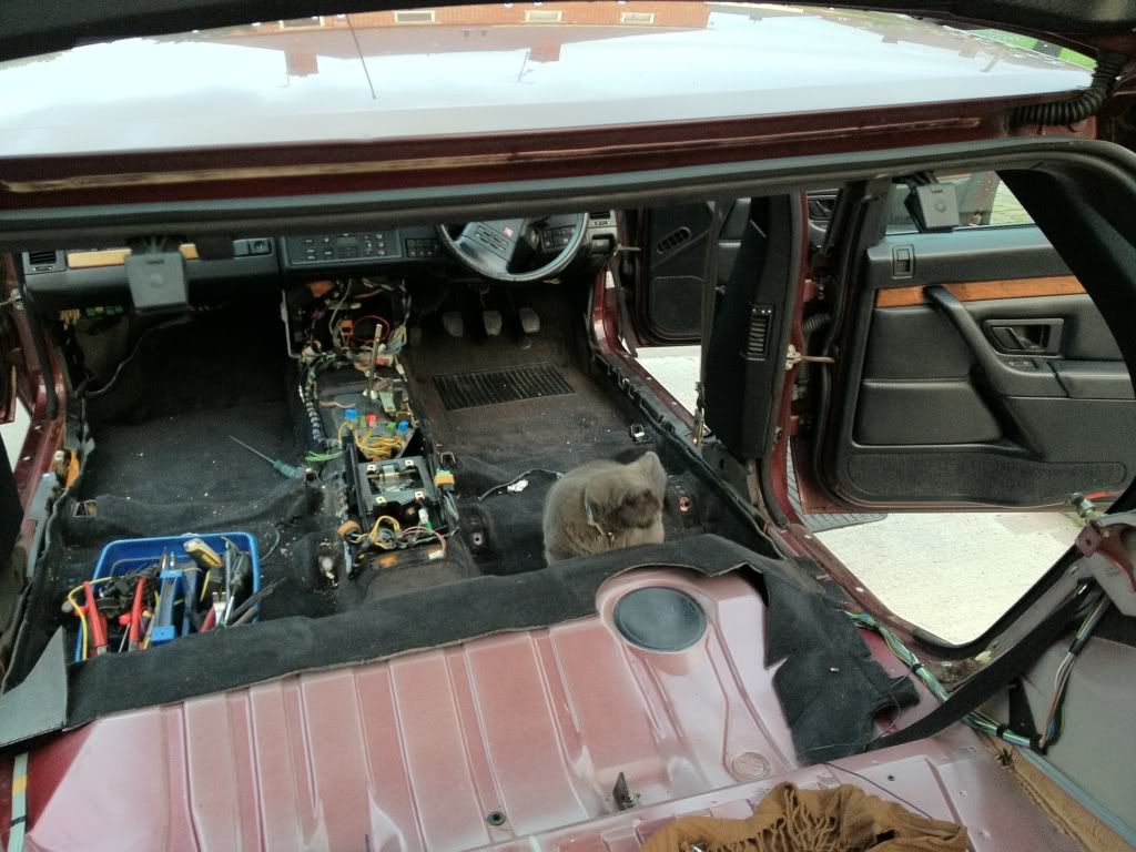

I've finally decided to put in some effort and install a proper sound system. Usually after installing it I decide to change the car and have to strip it out again, hopefully not this time...

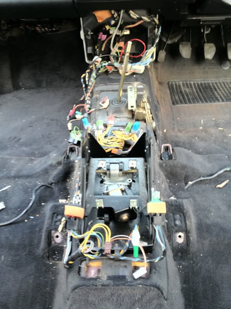

First job was to strip out some of the interior. The amount of crud in all the nooks crannies wasn't nice. What do people do with their cars. Gaffer tape wrapped around the fingers pulled up the stubborn stuff.

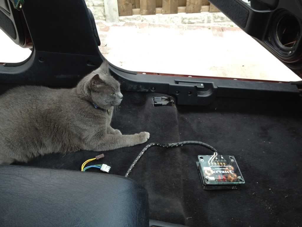

Zippy decided he needed to supervise things as usual

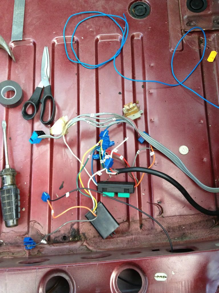

The amount of wiring for a 20 year old car says something about how well spec'd the XM was. The wiring for the towbar was messy and was just crammed into the corner stopping the light cover closing. The amount of scotch locks used was unbelievable, they'd even been used to join wires together instead of crimps. I marked up all the wires with cable tags and stripped it. The intention is to solder splices into the loom that are long enough to allow me to put the relays and buzzer into the 'structure' that supports the boot lip. This should really neaten up the wiring, provide physical protection and make changing tail lights easier. Because the lighting system on the XM uses a bulb detection system the towbar uses a relay bypass system which uses seperate 12v feed and uses the cars wiring loom to provide just switching voltage but I didn't like how the 12v feed was taken off the interior lighting circuit, a new feed has been put in. I've already added extra earthing for the light clusters.
With the power feed, speaker cables, RCAs and remote switching/control cables installed I started rebuilding the interior. The crossovers are going under the seats, the midbass and tweeter are going in stock positions.

It amazes me how much crud and muck gets under the centre console.
In any of the really dirty cars I have bought, I remove the front seats out and clean the whole thing with a wet/dry upholstery cleaner. It makes such a difference.
The worst car was a smokers 2.5 Estate that I broke, there was a mountain of ash forward of the gear lever under the centre console.
My Cats like cars as well, any excuse they can get to lie up on the parcel shelf or even the dash is pounced upon!

Nice cat! Nice photo Robert.

The wiring after removing the scotch locks, using bullet connectors, etc. Wrapping in spiral wrap.
It fits in the box section but what I didn't find during planning was a metal protrusion that stops the electronics sliding in from the end cut out.
I'm not happy with the 'loom' sticking out, I need to disconnect the wires and fish them through from the end cut out.
Plenty of additional earthing. One each for the light cluster, electronics, towbar socket and interior light circuit. The paint was sanded from the earthing point first.
