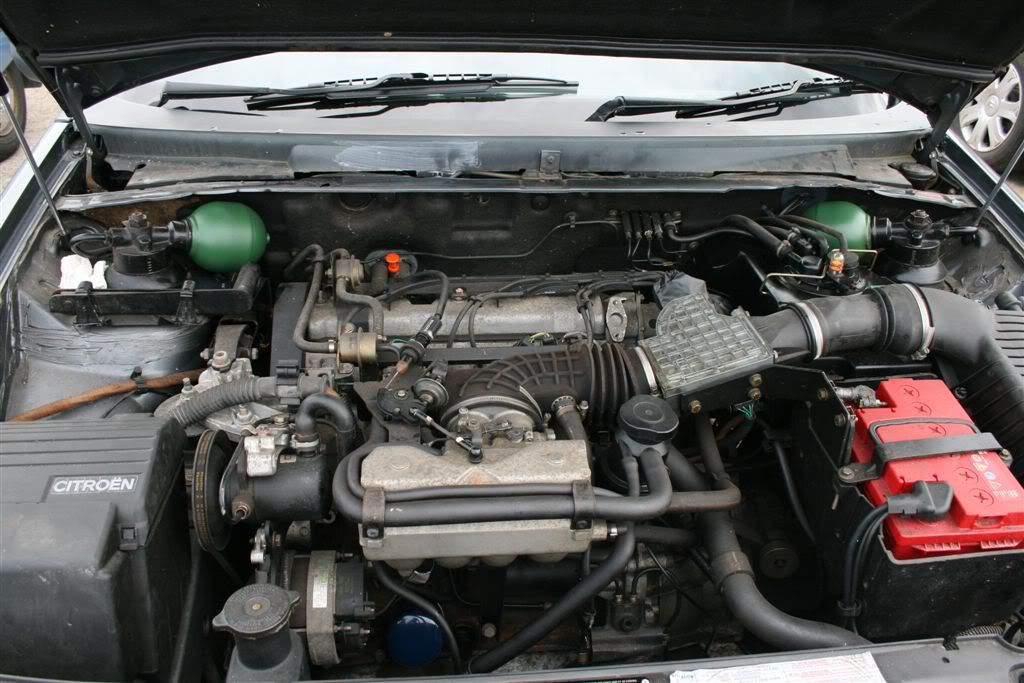

Re: eBay Motronic diagnosis kit any use to someone
This is mine here
I think its the Motronic. It has a distributor cap, and rotor arm, and the smaller ignition amplifier module on the back of the distributor.
Hi Robert
yours is the slightly less powerfull (122bhp) Magnetti marrelli system, the motronic is the later bosch system fitted to S1.5's.
All i can see it does is read the fault codes as the ecu's are not capable of doing anything else. This age vehicle is a bit of a pig to work on really, all the toys like oxygen sensor and multipoint injection with inlet air temp sensor and crank and throttle position sensor but without the ability to give real time info of ignition adv and retard, temp idle speed, fuel pressure etc etc, all you get is a two digit code for faults which can be a bit vague (like 63 = 'Lambda control') real time info like what obd2 can give is a must for those stubburn hard to diagnose problems.
If the price is still low at the end of the auction i will have it and see what it does but im expecting it to be useless for anything other than teves abs diagnostics where it will just make diagnosis possible without breaking out the ohmeter.......not something i will pay big money to do as im not sure the teves this machine is compatible with is the same that is fitted to MK2 xm's, if it turns out to be usefull im sure it could be passed around a few trusted people if its needed.
i just hope the discription is right and its for motronic and not monotronic
Interesting, Mr Russek leads me to believe that I have a LE2 Jetronic system. And that Bosch Motronic was fitted from 1993, so the series 1.5s. Magnetti Marelli Multipoint was fitted from 1991.
Anyway, their diagnostic machine is probably of little use to me.
