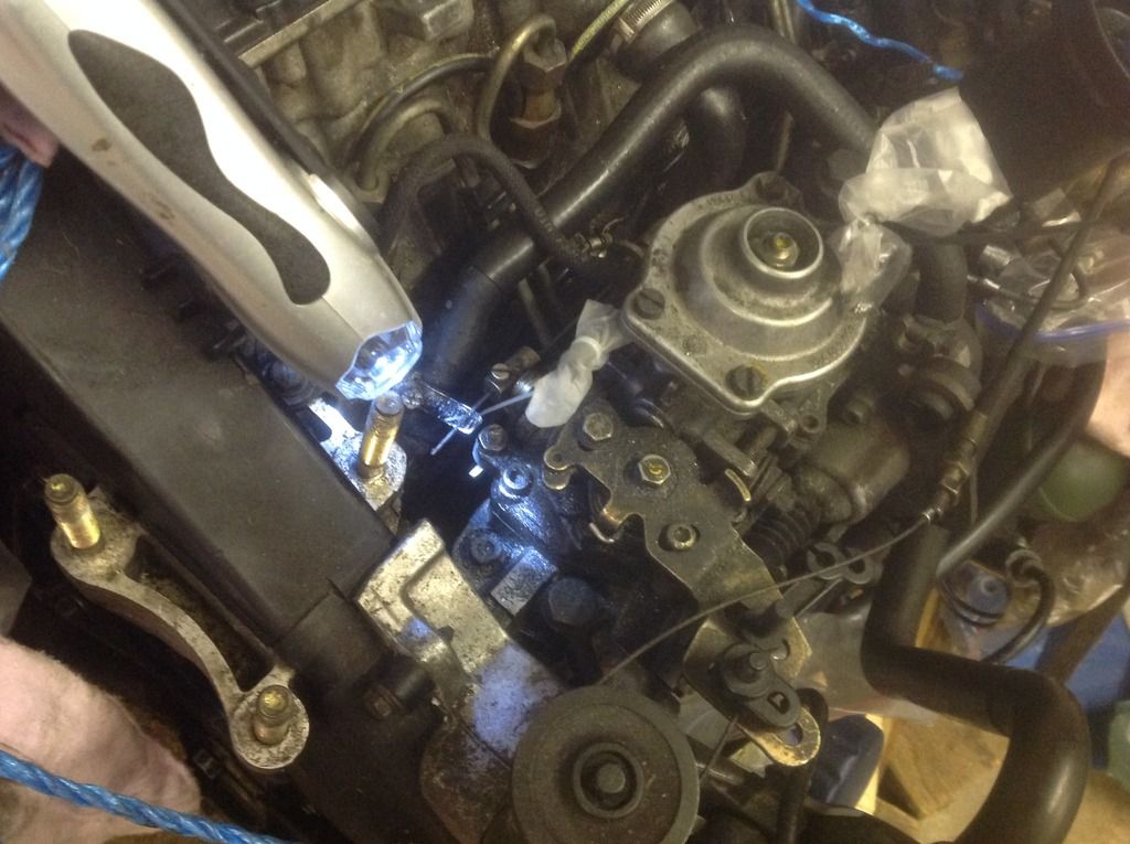

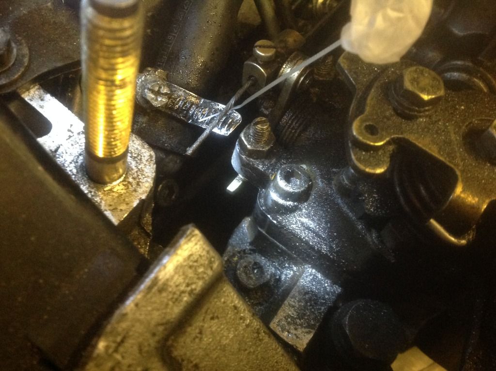

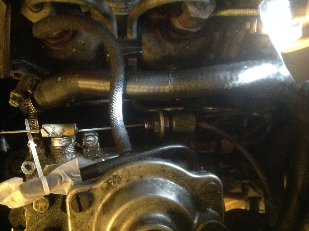

Sorry Ray, I didn't see your post till after I had tinkered. So here's some pics from the spare engine, a little easier to get at.
You can see the cable, the adjustment locking screws and the arm, which is spring loaded, that rests on the cold idle screw to the left, or the hot which is to the right of the pump. The arm in between the idle screws rests on the screws underneath them. So when the car is cold, the waxstat holds the cable back towards the right which then pulls the arm back and rests on the left cold idle screw underneath it. So I had to pull the mechanism back to the right to get the setting right and tighten up the locking nuts. It's very easy.
[/[URL=http://s1048.photobucket.com/user/rjwal ... .jpeg.html]Image

Thanks Russ, I just wanted to see what it looked like in case I had a problem with it.
