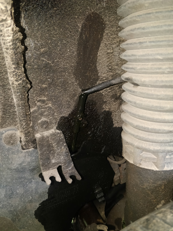

Hey there, thought I'd introduce myself! I'm David and this is my new xm I got yesterday! Image bought it as a hopeful daily driver, seller originally gave me a bit of a list of problems it has like the locks being buggered and the low beams not working and the heater only works on full blast, all seemed like simple issues to fit, was quite far away so I got a company to deliver it.
All seemed good till it was driven off the trailer and hydraulic oil started pooling up on the floor by the front right hand side, which was to say the least bit heart wrenching and I'm yet to actually dive into where this is actually leaking from. But today's a new daily and I'm feeling a bit more hopeful! 😁

I think I'm right to say that hydraulic oil (LHM) leak will be from a low pressure return, as the suspension raised enough to be loaded and unloaded from the trailer? A leak on the low pressure return means an easier fix.

Have a look on the back of the hydraulic cylinder,. Theres a rubber draining house wich returns the LHM fluid to the canister.
When it breaks the leak is quite often mighty.

The rubber leak back hose is P# 95050399
The clip that retains it is P# 96127591
Consider this part a consumable item, so order a pair. If yours has the original stainless steel, click-clip, you can reuse it, if not order new clips, or a hose and clip as a kit.
The hoses normally perish and split at the top, where it pushes onto the steel return pipe. As a temporary measure, cut the hose off the steel pipe and push the remaining hose on.

Found the leak, its the pipe coming out of the strut, is this the same one you guys showed me? Image

The split pipe is indeed the one already discussed. It's easy to fit, just make note of which hole it pokes through in the bracket welded onto the strut.
For now just insert a pipe, or cut it off and re-attach it.
