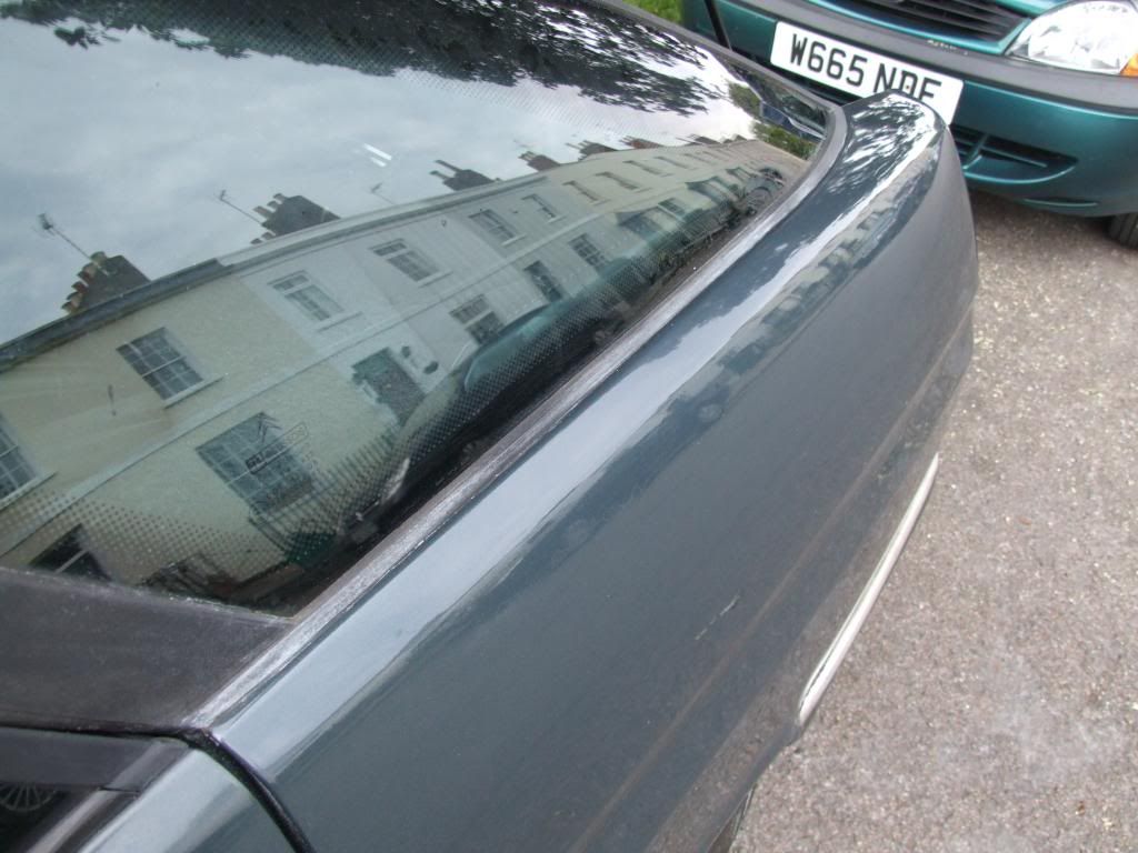

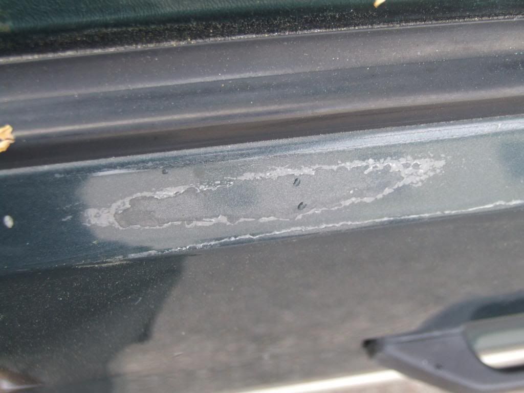

As promised, here are some pics of my lacquer work and dodgy patch on the rear passenger door. ;)
The very top of the wing was cracked and starting to flake. it really was looking a mess. It was much like the door, but ran most of the length of the wing. So I sanded it back and re lacquered it on Monday. I left it alone sitting in the sun since to let it cure. Got some halfords rubbing compound yesterday along with some 1200 and 1500 wet and dry. So today, I sanded back the overspray and got rid of some scratches ect and then used the rubbing compound, followed by T cut and so far that is it. I will need to polish and wax it, but i might was well do that on the whole car. the T cut has polish in it anyway. But i'm quite pleased for a quick touch up. The Halfords rubbing compound I highly recommend. I dont have a orbital polisher, so just used elbow grease. And thats all it needed. It is coarser than T cut, but is very effective. I will use it on other scratches ect.
The door unfortunately is another issue. I did start to sand it this afternoon, but found the old lacquer is creating a lip which i cant seem to feather out. It is also starting to remove the paint too. So I fear it is a case of really sanding it back and repainting and re lacquering. A bit more involved than i would like, but once I have some paint, it should only take a weekend. At least it is only on the upper surface too. the rest of the door is fine.

Post by CitroJim » Sat Jun 08, 2013 5:48 am
Russ, a very excellent job. Well done :D

Post by citroenxm » Sun Jun 09, 2013 8:51 am
:o STUNNING!
Can you come and do some for me! Luckilly the SD From what I remember here at home, has no Laquer issues at the moment, just the spotty paint on it. The Older H reg SED is starting to, but at the moment is mostly bad on removable parts..
