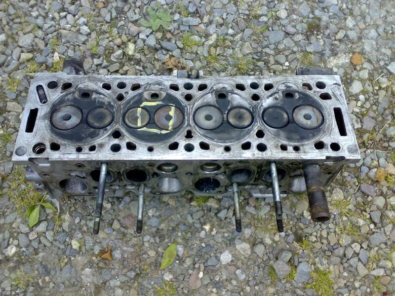

1.9 TD head:

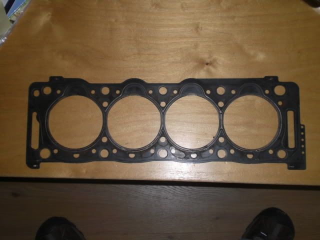

2.1 TD gasket
The only significant difference is on the lower row of water ways on the head between cys 1&2 and 3&4 where one hole appears 'off-set' to the pattern shown on the gasket. I would of thought a slight tinkering of the gasket would overcome this...
