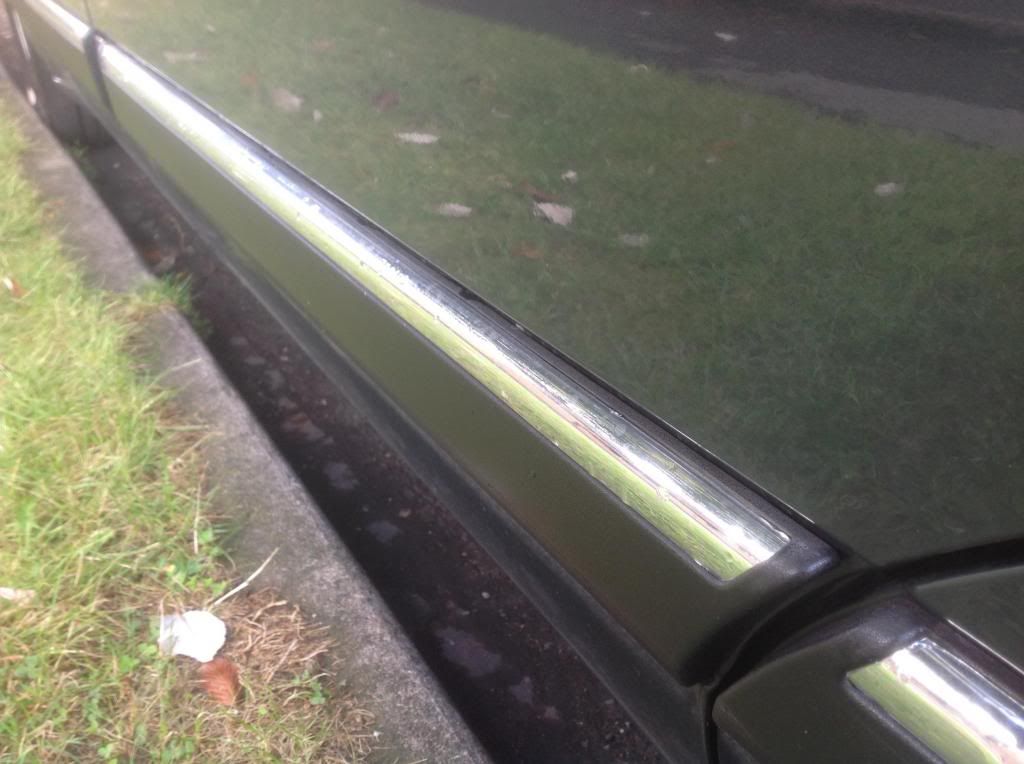

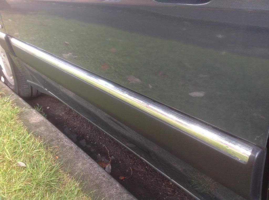

Here are a couple of pics I found. They are not great, they don't really show the full effect.
I will take fresh ones tomorrow.

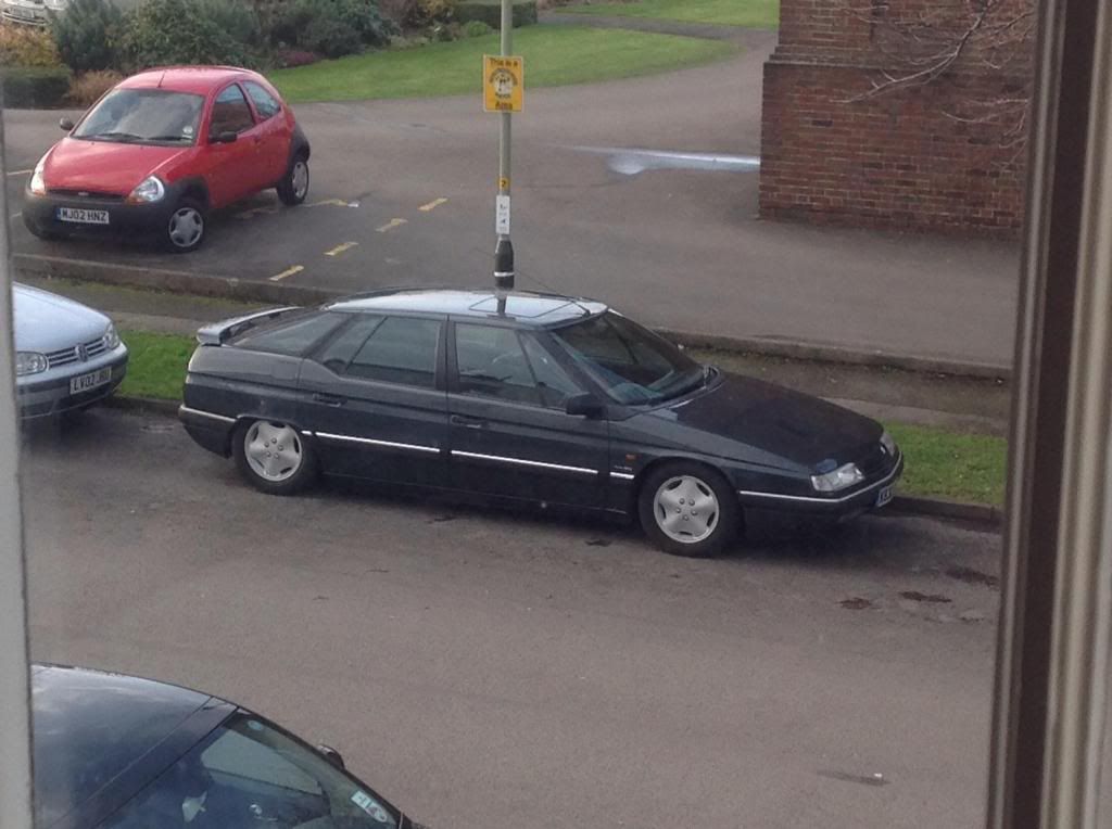

Found one of the car, you can see the chrome tape looks very bright.
Strange looking at a grey XM now!
