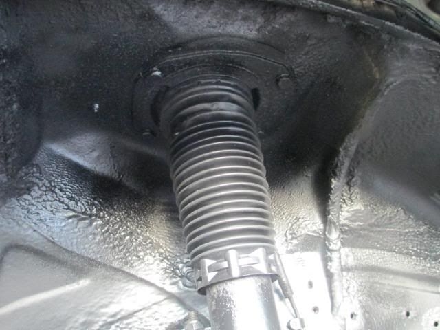

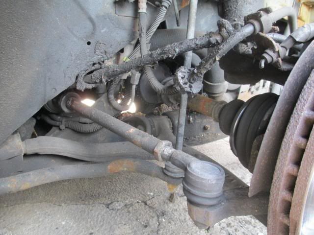

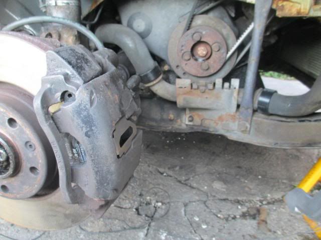

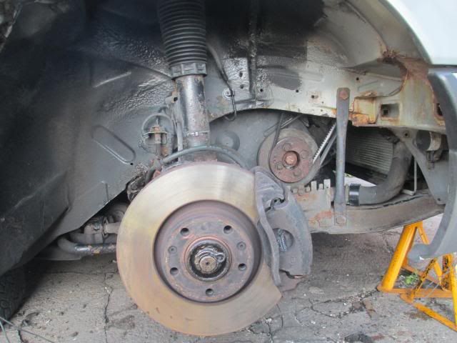

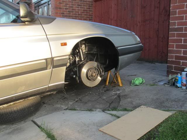

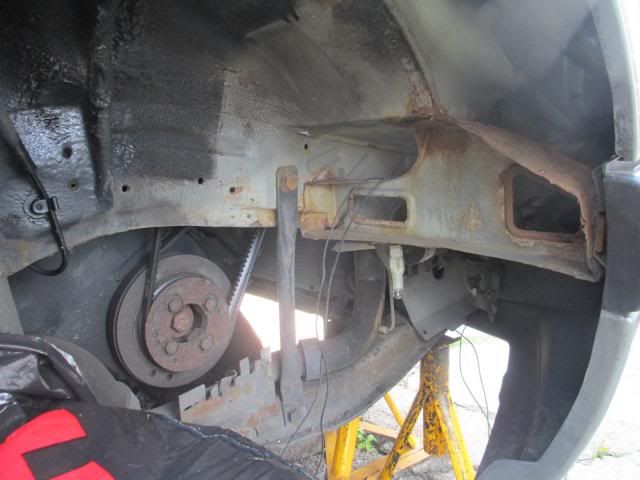

Well the work continues on the xm....yesterday I got quite a lot done. As planned I tackled the OSF wheel arch area. Took the liners out and discovered a bit of rust. nothing too dramatic but it looked a bit tatty in there. I also found some more mysterious wiring (this car has loads) which has been clipped off and just left in place behind the liner. Anyway...with the liners out, this is what I was left with: (this is the side where I discovered the inner cv boot had split recently.

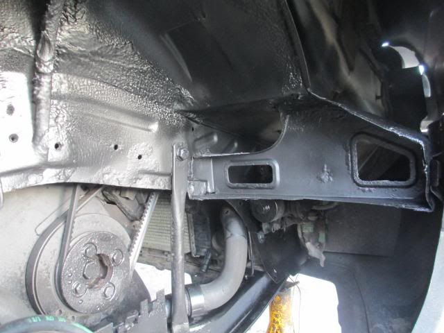

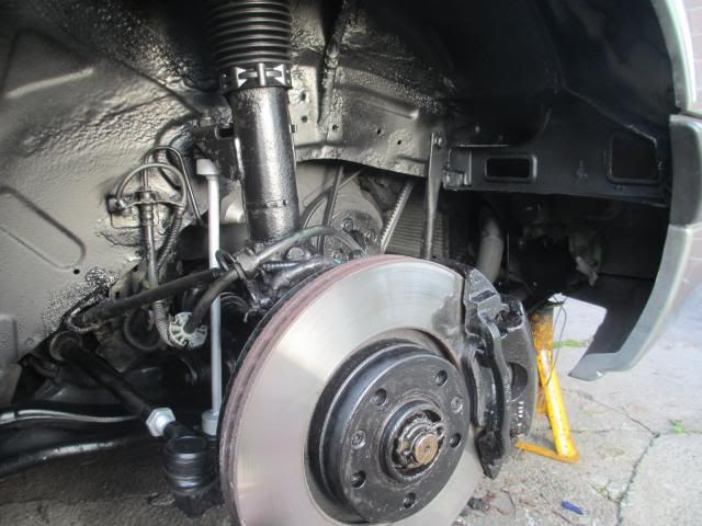

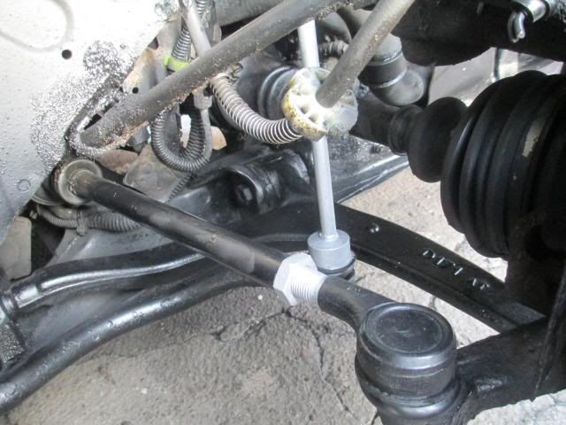

So, the plan was/is to clean up any rough areas on the car and protect them for the future. I removed the rust of everything with a combination of wire brushes and rust remover, then have stone guarded all the panel work and visible parts of the subframe, smooth hammerited the caliper and satin blacked everything else. I cleaned everything painted the silver bits silver to again protect again corrosion. No one is going to see this stuff as it sits behind the arch liners, but for me I know its protected and for an future owners of the car it gives them a record of what work has been done to it.
One for Paul this.....Paul you know I was saying I had an noise on the auxiliary drive, and you mentioned that Alan's has a similar problem...Well mine turns out its on the crank pulley. I had a good listen with the area stripped back, and ran the engine. Noise started and was quite loud with the covers off. Then doused the Inner section of the pulley with wd40 type stuff and it all went quiet again....A job for the future I think
Anyway...today I will be refitting the degreased and renovated arch liners to finish off the job, but for now this is how the renovated arch area looks like.
