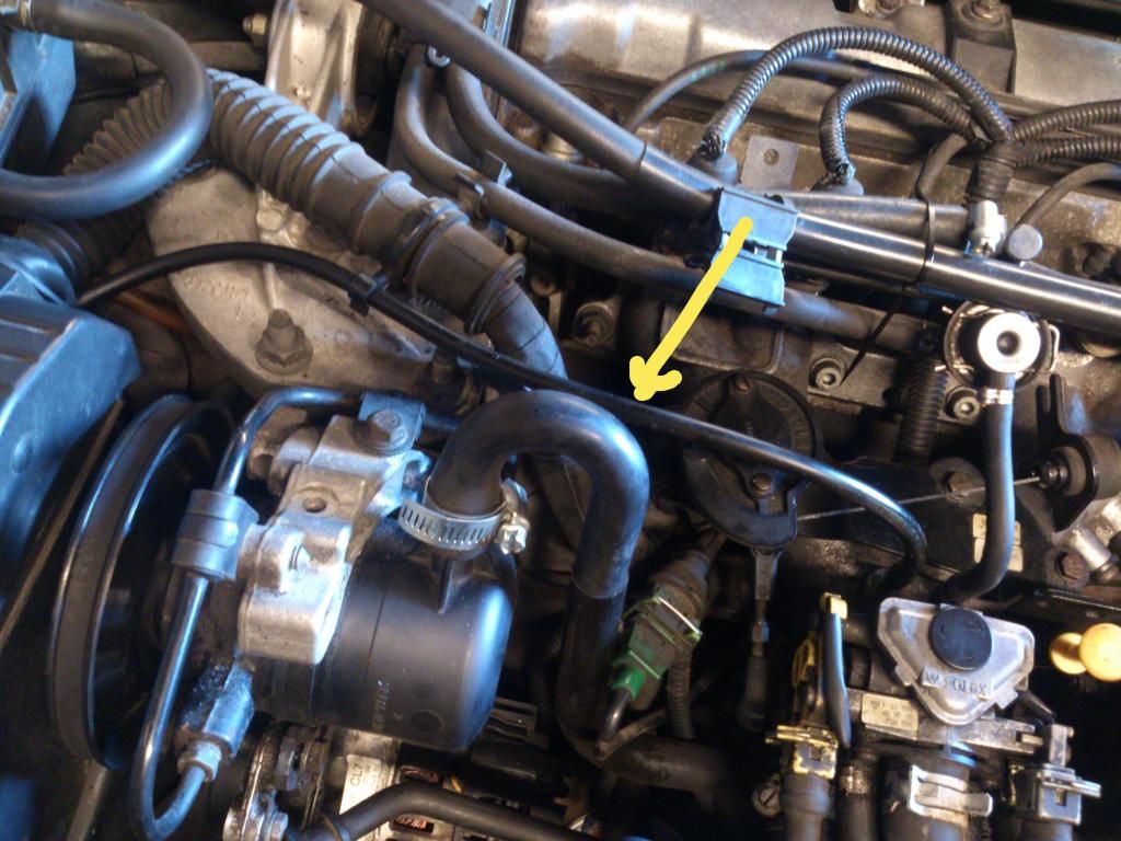

Yes, it's surely the early version. It certainly does have the vac tube to the ECU seen here:

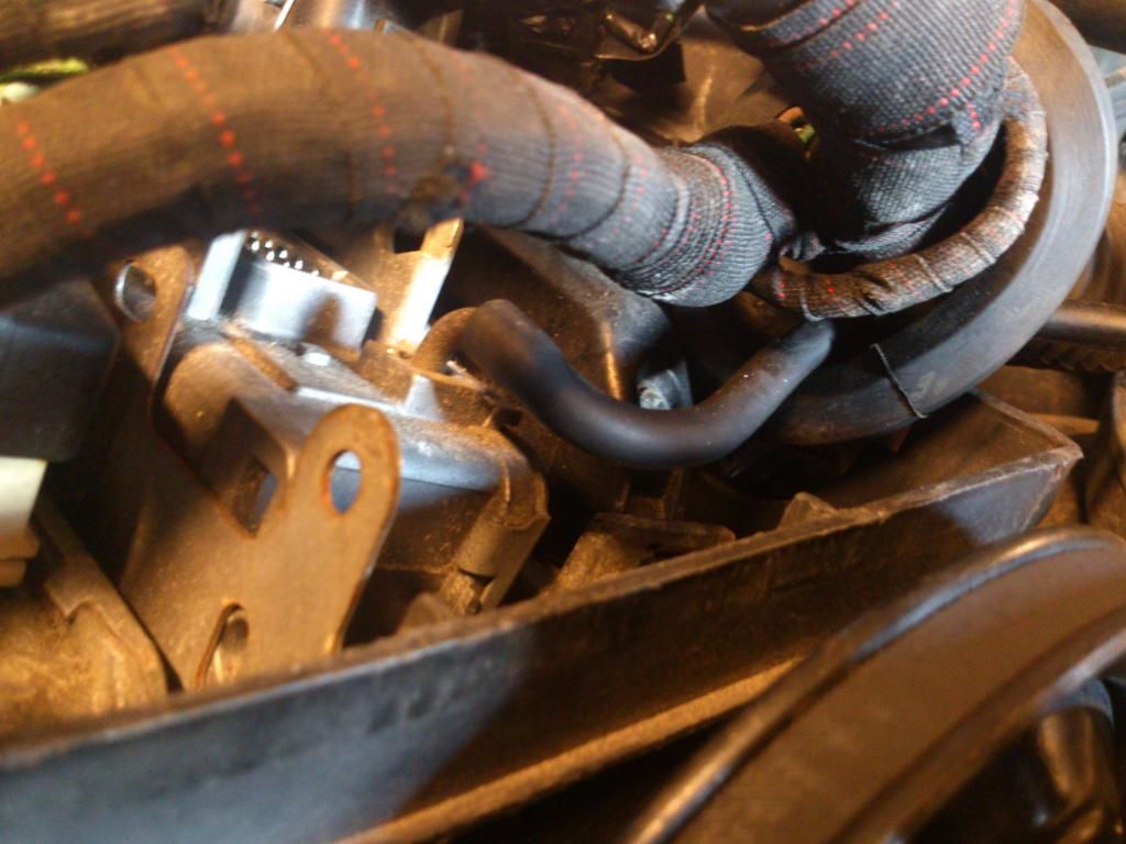

And the connection at the ECU is like this:
