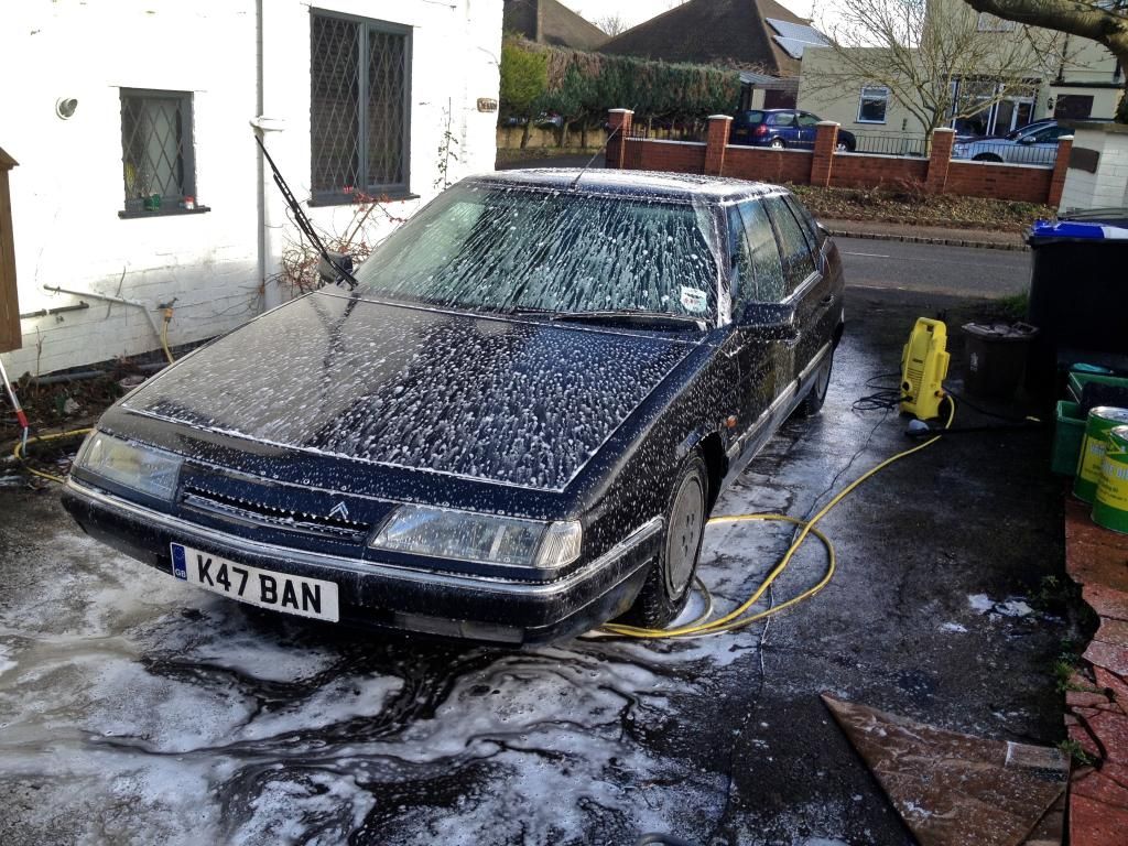

Gave the car a snow foam (just to wind up Dieselman) and a good wash yesterday in preparation for Vince this weekend.
Needless to say on the frostiest morning since picking it up, this and the veg oil were not good ideas as the inside of the windows was iced (moisture getting in) and the car sputtered into life to die again twice before finally the fuel started flowing. So I might put a bit more diesel in the car.
