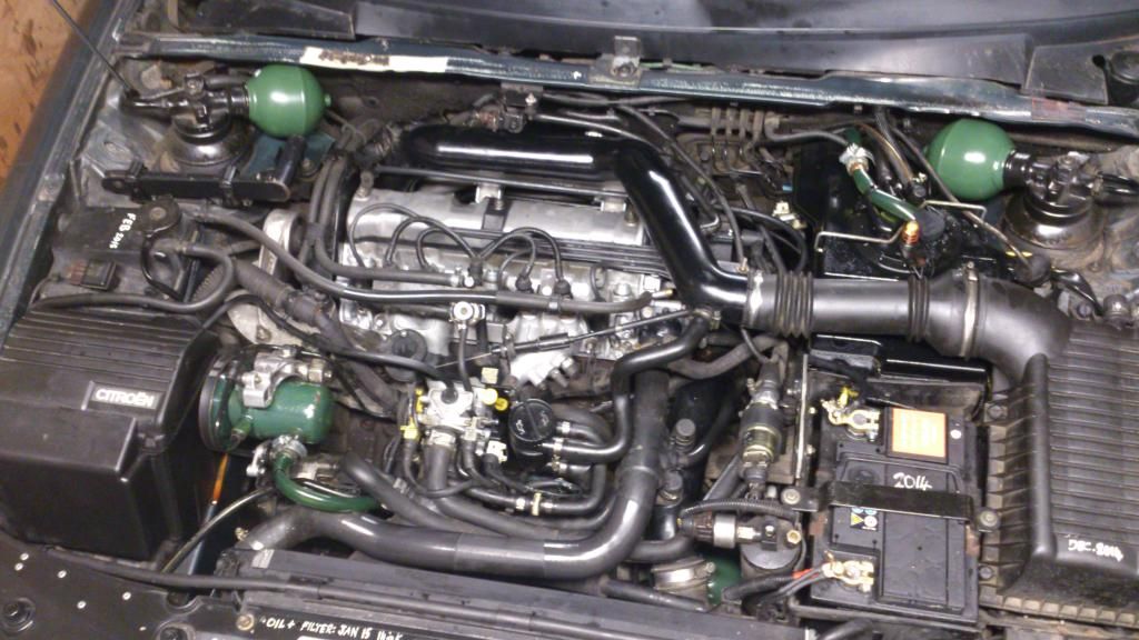

Looking super smart now, one thing to consider is the Lambda sensor, glycol can poison them I believe.

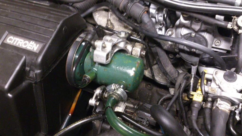

Clever suspension tank fix. I like the idea of clear tubing for the pump pipe. I'm into clear pipes now.. Quite interesting seeing the fuel flow on mine. But with the LHM, easy to check the colour it.
Looking very smart that engine.

Hi Dean, I hope not - it's a recently - fitted genuine Bosch lamda sensor! wasn't cheap! I still have the original sensor but i think it's as old as the car. The head gasket going was not severe before the work so hopefully that wouldn't have been too damaging to the Lamda sensor?
Cheers Russ, I can't take credit for the mod to the LHM tank as it was covered some time ago on the FCF forum (including a VERY lengthy debate on the phenomenon of air bubbles in the tank) But it is still working. All you need is a pipe that extends vertically down from the return pipe inlet to a few mm from the bottom - basically as long as it's well below the LHM surface. I don't know why LHM has this tendency to bubble when it has fluid added to it as working hydraulic fluids tend to have anti-foaming agent in them to prevent this. I know from my Mountain biking that the suspension fork oil (same stuff as in motorbikes) has anti foaming agent in it so that the churning of the damper leg doesn't cause cavitation but on this the only air interplay is at the tank itself.

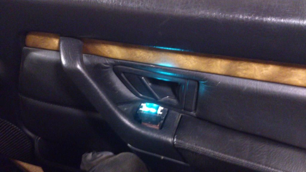

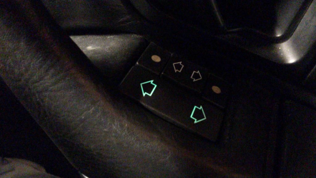

This evening I have been playing with LEDs again!

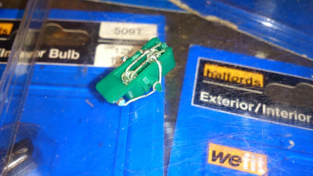

After the success of the LEDs in the seat switches and the doors I wanted a better sped of light behind the switch for the doors as it wasn't illuminating both arrows equally. I wanted to try making a double LED switch. So here is the first prototype
And lit up
it's pretty bright! and these are the standard 3mm white LEDs - not even the mega bright ones John sent me
And with the switch rocker back in place - it's lighting up both arrows now
I'll probably change the passenger door switch to a doubler as well and then the rear doors and then I'll be satisfied... see when you start something...

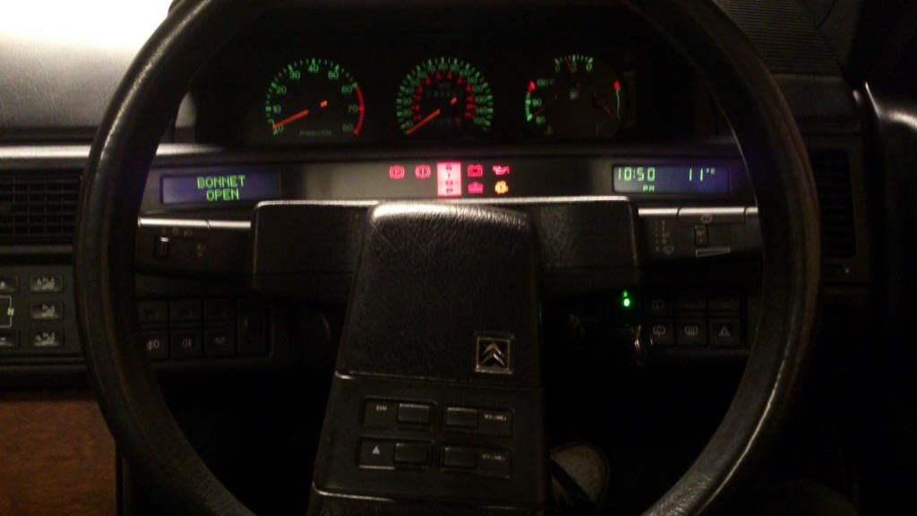

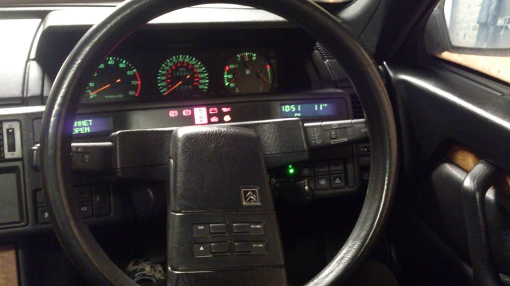

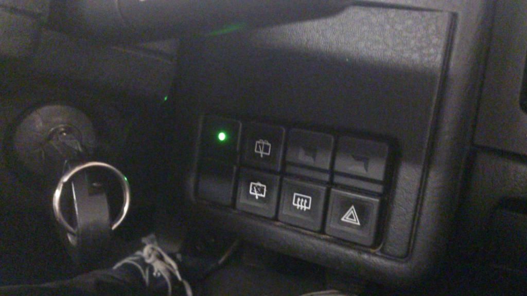

The LED craziness continues! There's a new LED here
It's a tell tale LED that lights with the Hydractive electro-valve so you can watch the switching and when it decides to switch to stiff mode.
It's quite interesting to watch and no need to tune the radio to LW. I can confirm the body movement sensor is working now after I had wondered how well it was working.
I also fitted the spare HP pump from a BX 16 to the car. It's structurally the same at the XM pump but has a smaller pulley so should spin faster at idle. I was hoping the PAS might be improved at low parking speeds as it's quite heavy on this car. I already changed the FDV to the Xantia one that has a larger center hole in the metering disk in the first valve that should let more LHM to the pinion valve but it wasn't a great difference.
The PAS is much lighter with this pump but it makes a racket when it's off load. The original XM pump is also noisy off load but this is worse. At least it doesn't seem to be drawing in air via the bearing shaft like the original pump seems to.
And lit up
