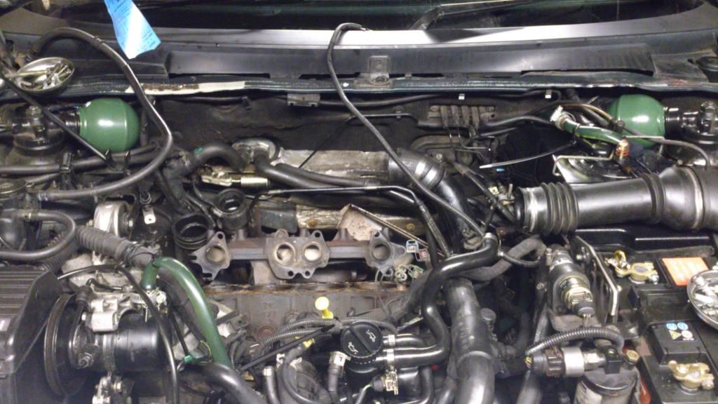

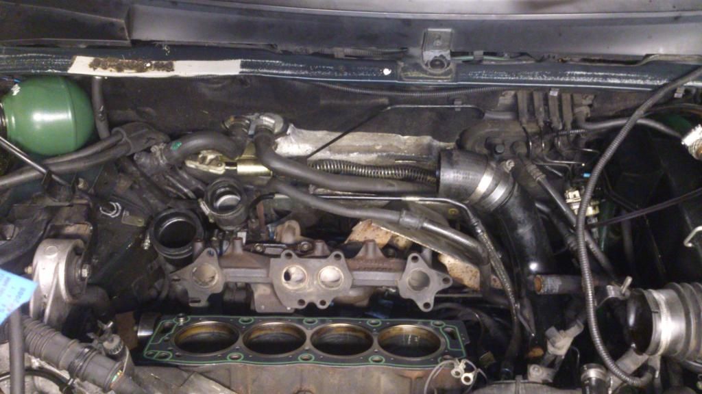

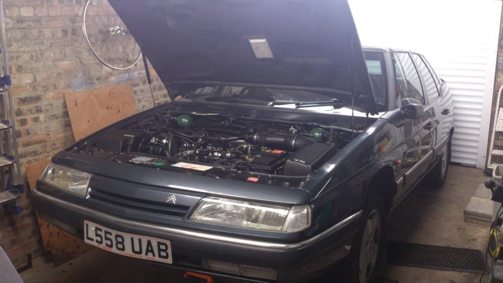

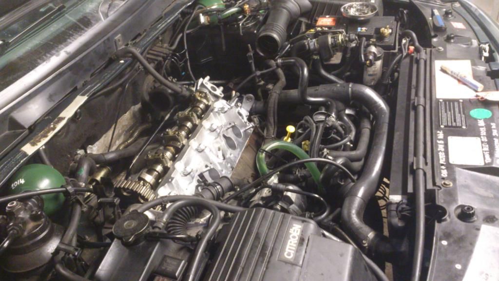

Head ready to go back on

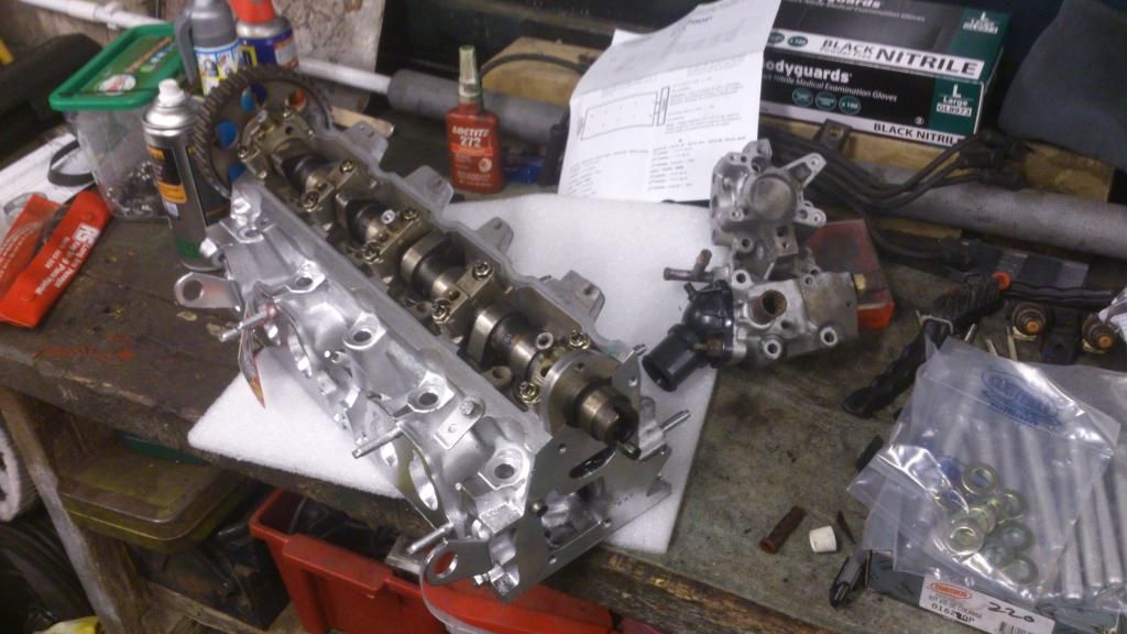

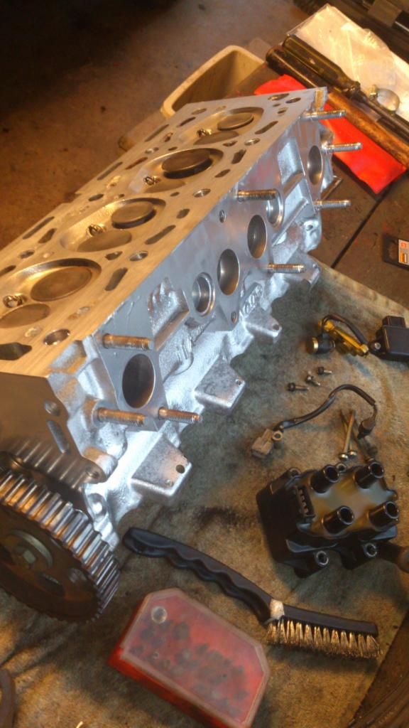

Shiny bits to go on

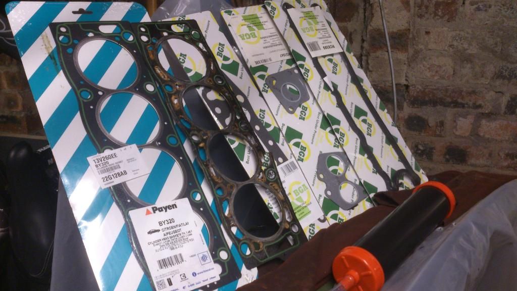

Many gaskets to replace

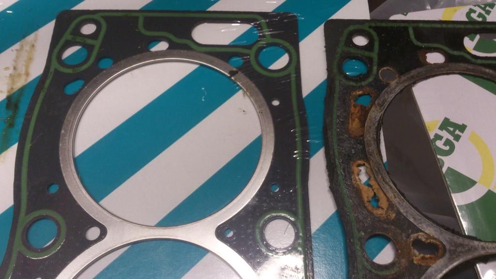

Head gaskets: initially I thought the new one was wrong due to the small coolant holes on it. Then realised the old ones were enlarged due to serious corrosion. The many flakes of wich had piled up inside the engine block and took hours to remove
Shiny bits to go on

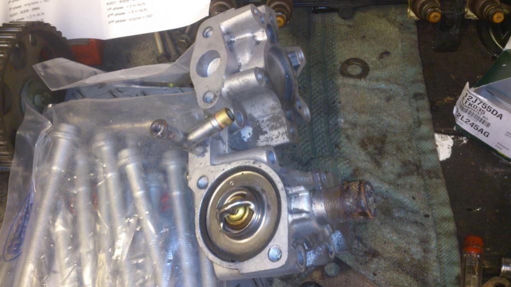

New thermostat, plastic housing and cleaned up casting alongside the new cylinder head bolts

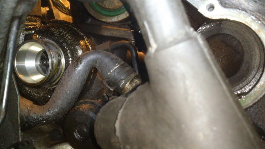

Checked and cleaned the turbo - it was manly on the outside but inside out wad clean and span well with no bearing badness

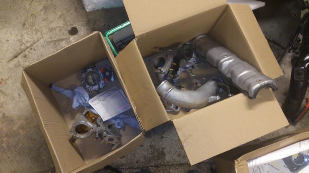

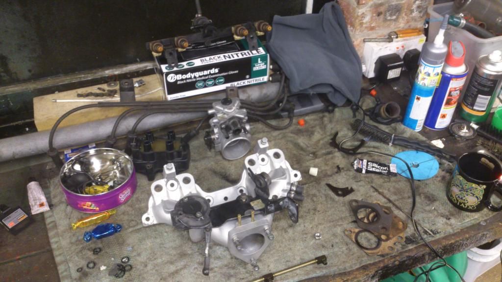

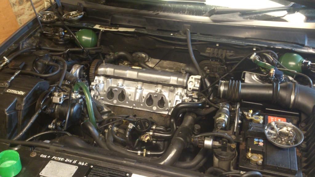

Intake manifold, throttle body and it's sensors, fuel rail. Only the latter was not cleaned tho the injectors were relieved of theit black grot

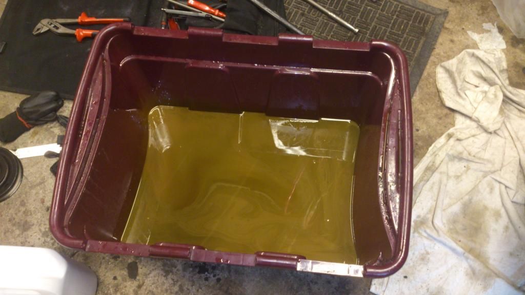

This is what came out the sump.. Oil shouldn't be this colour! This was brand new oil changed two weeks ago

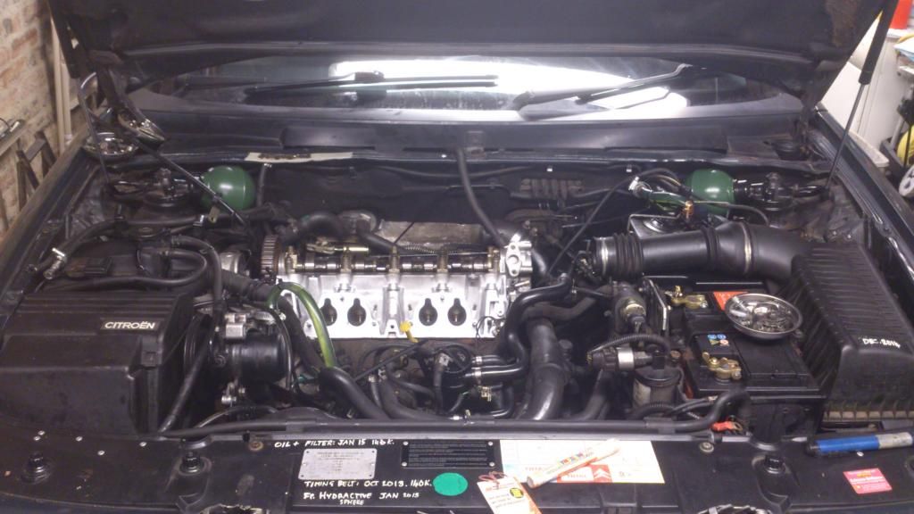

Ready for fitment. This is just after the head was tightened

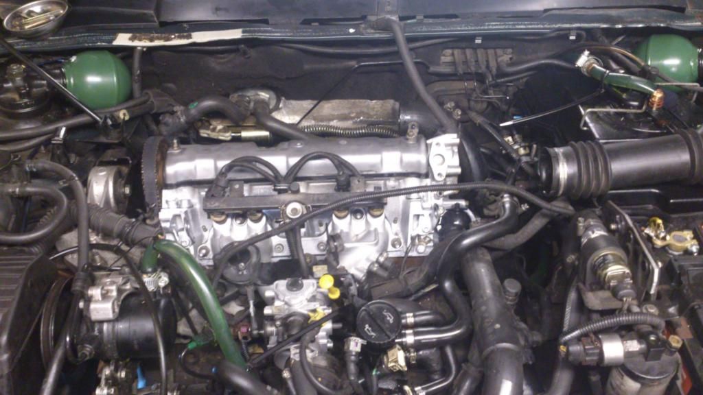

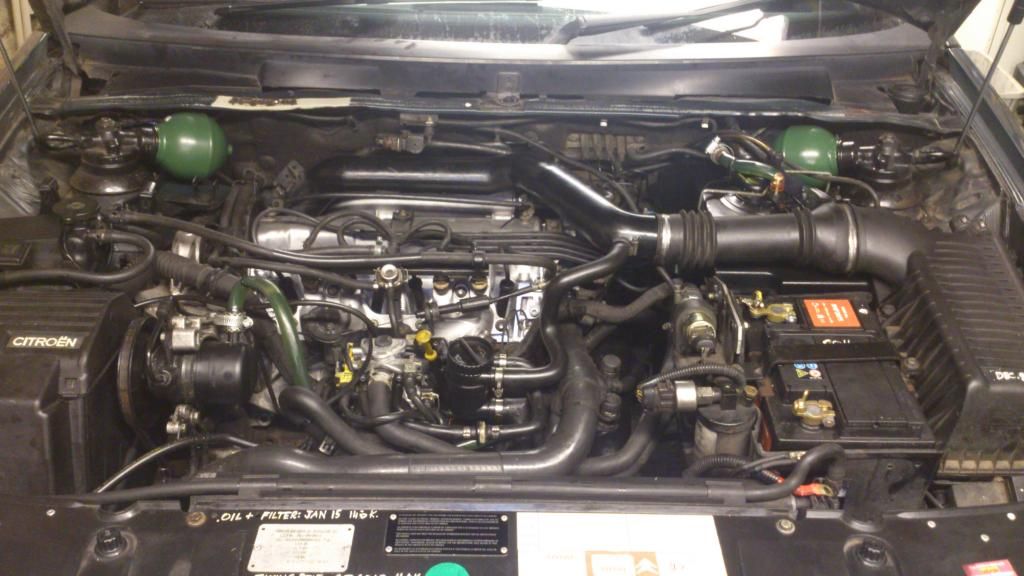

Next up the assembled intake and cleaned up throttle housing hopefully help with my running issue

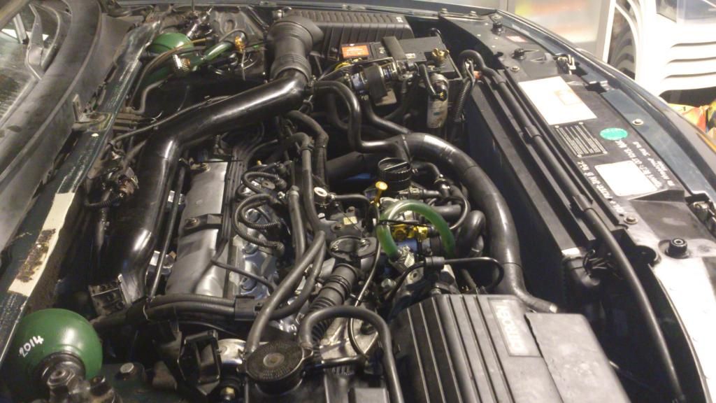

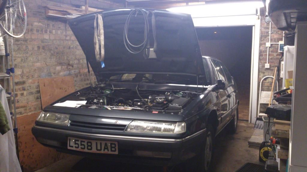

Finalising, coolant etc
New plug leads, water pump, timing belt, oil too so here's hoping out works out

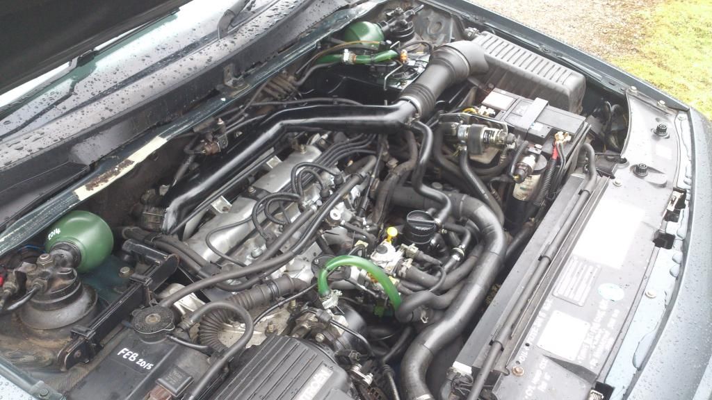

Outside work today lunch time
