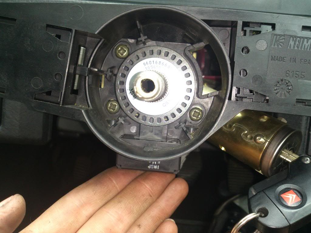

Anyone know how to reach the steering sensor?

Thanks chaps, it'll take a little bit of time to get the 12v LEDs and resistor etc and in the mean time I reconnected the body motion sensor and again, same behaviour - goes into hard after a mile, nothing new.
A problem I noticed on the drive home after collecting the car a few weeks ago was that the steering column was not straight - the reach/height adjustment was really stiff and seemed asymmetrical. I wanted to have a look at the steering angle sensor and the throttle sensor anyway before I have the LED tester available so removed the column surround to find some strangeness. Firstly, right away I found the mounting nuts of the column were totally off centre so that was a nice simple explanation to the off centre steering wheel- loosened, centred, retightened and boom! fixed. I noticed that after taking out the steering wheel control commutator ring that the steering sensor was behind it but odd thing was that the optical disk was not actually running between the sensors
I removed the sensor and connected it to the plug and with the igintion on was expecting to see light appear in the little slots on one side but nothing (doesn't mean anything as I don't know for sure if it is visible) Anyway, cleaned the whole thing with contact cleaner as it was very dusty and refitted it with the optical disk running in the slot of the sensor as I assume it does. I first assembles things with the steering sensor disconnected and went for a drive - usual result: stays soft for a mile then hard. Back, reconnect the steering sensor and refit the column surrounds and next disconnect the plug at the accelerator pedal, I'm expecting this to make no difference like the rest because the fault is still to be read by the LED reader.
Odd result. It stays in soft mode now - permanently. Using LW radio you can now hear the electrovalve doesn't disconnect at all regardless of speed, steering hump-backed bridge or other. Switch to sport mode and...... still soft.
I wasn't expecting that at all and I must say that although it's clearly still not working properly, I can live with the perma- soft mode better than the sport until it's diagnosed.
Is this to be expected?
Also, the steering feel has improved a good bit after straightening the column - it must also have been rubbing on something.
The HP pump has quietened down a couple of days after replacing the pump suction hose clips so perhaps the pump was half full of air.
