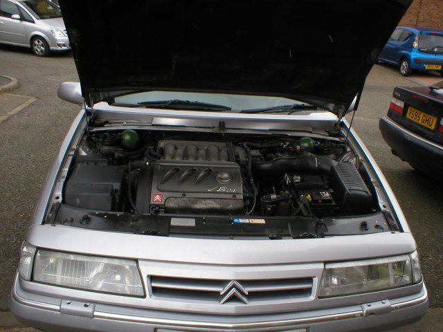

But first, as requested by Matthew, a shot of the engine bay showing the bundle of fun under the bonnet

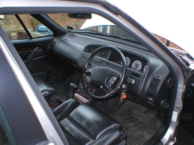

And the interior. All very black and as cool as a cool thing:

I don't know how Citroen have done it really; you'd have thought a non-sunroof car with a black interior would be sombre and claustrophobic but it's just the opposite. I love it
