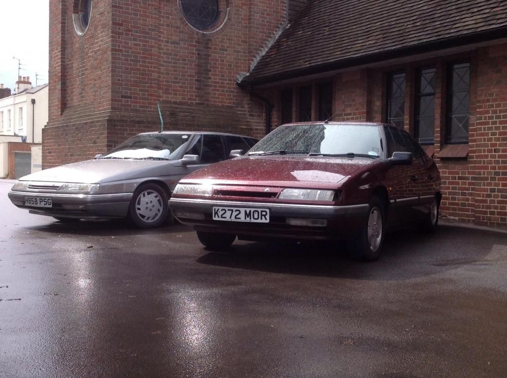

russ92xmsed wrote:Image
Yes I know, grill is missing and the side light. Took them out to do bumper swap... Thought the nose cone had to come off, only to find you don't need to do that. Ahem!
I'll get some better ones at some point. :D I really need to do a good clean and polish. Get her sparkling.
