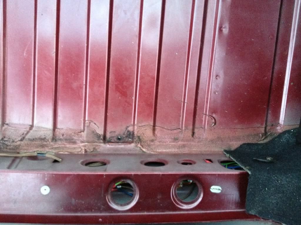

I managed to get the towbar wiring entirely in the box section but had to remove the spiral wrap to do it.

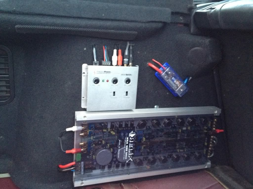

After mounting a wooden backing board to the reinforcing on the wheel arch I could decide where to place the equipment so that the cabling could be routed. Here's the end result, not flash but tidy.
The speakers still need mounting and the battery connection made. The XM has an advantage when it comes to ICE installs, the interior volume of the car is large which helps with bass extension. The Prius has a JBL factory fit system which is OK but lacks depth, adding a Bazooka tube has improved it but because of the bespoke nature of it it's difficult to improve it greatly without replacing it all. The amplifier uses balanced inputs from the head unit, the sat nav links directly to the amplifier and the volume is controlled by the amp not the head unit.

The ICE install was finished and tested. The Maxxbass processor worked brilliantly with the front components adding depth but it was just too noisy. I can't understand why the developers/manufacturers spend all that time and money to develop such a complex algorithm that works so well only to implement it so poorly. The amount of noise on start up and between music was intollerable, it had to go and it has. Maybe I'll try my hand at a nice bandpass enclosure for the Focal sub next.
