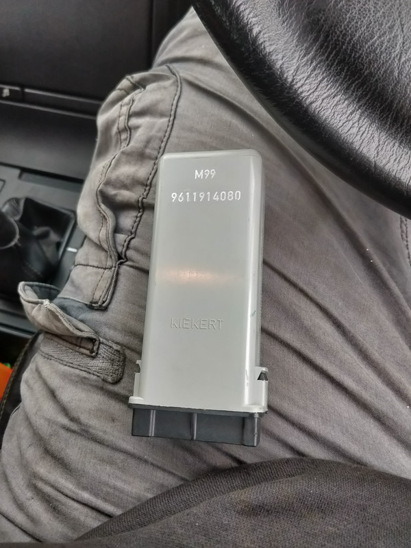

Also I've been sorting the locking issue and thought I'd try for this remote receiver but I can't find anywhere to actually plug it in
Also the infrared bit isn't actually plugged into anything?

The grey box is a central locking unit, the remote receiver is in the centre of the roof console, with the orange wires leading to it.
Is that a Citroen Kiekert box, it looks like a Jaguar one.
The leak from the pressure regulator base is just a small weep, certainly not enough to cause a pressure issue.

Is that what I need for the plip to work? Where do I plug it in?Dieselman wrote: ↑Sat Nov 01, 2025 6:38 pmThe grey box is a central locking unit, the remote receiver is in the centre of the roof console, with the orange wires leading to it.
A quick search of the part online come up with a citroën/peugeot Central control unit so I'd say definitely not jag

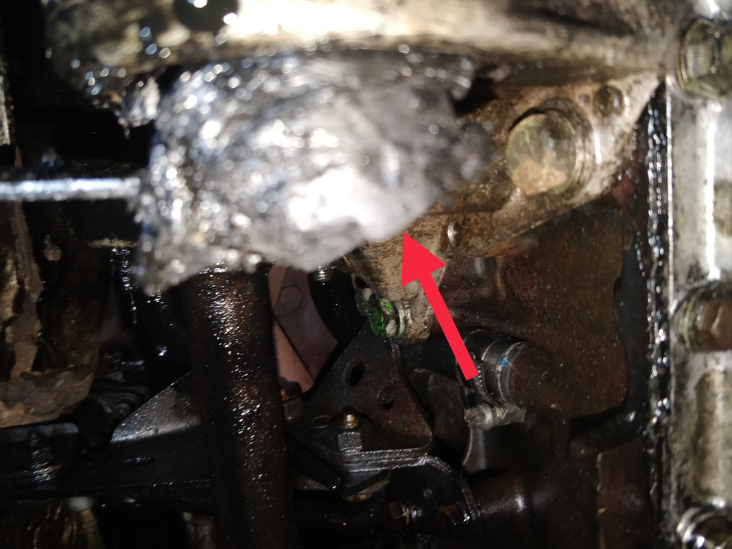

Have also notice a horrendous oil leak, looks like the sump gasket has gone and just pours oil from where the pan goes on the block, once again looks like a pretty easy fix putting a new gasket on

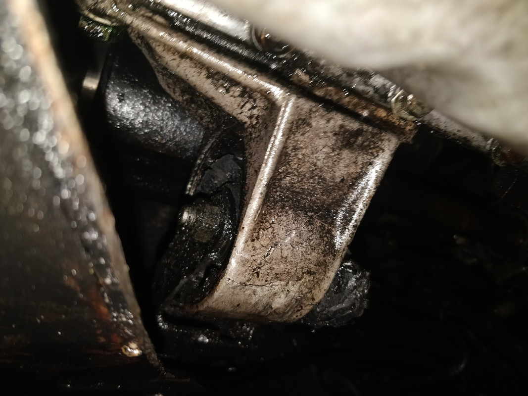

Then in noticing that I saw the condition of the rear lower mount and I have to say it's probably the worst condition mount I've ever seen, how on early they passed it as an advisory on its last MOT I'll never know
it's hard to see in th first picture and I didn't get a very good picture of the other side but you can see the entire thing has blown out the side

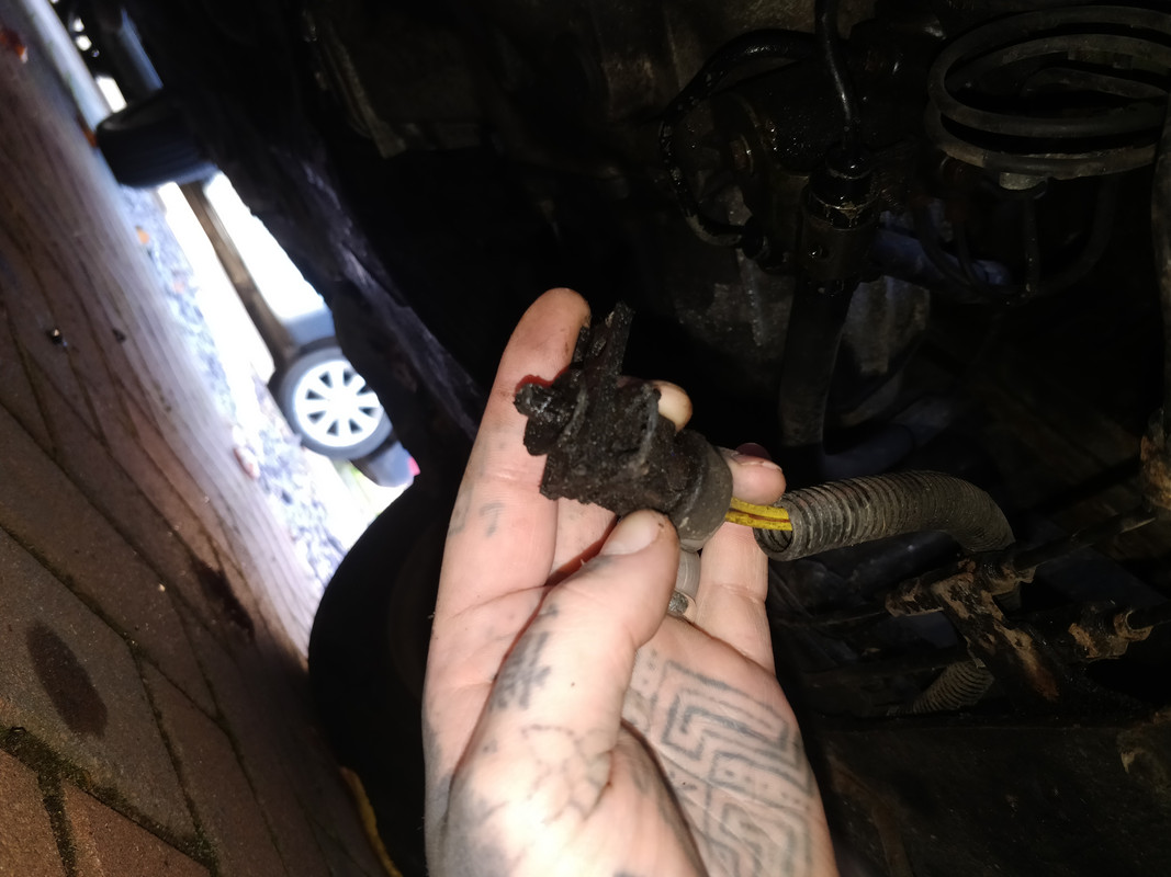

so I'll also order a new one of those to be pressed inThen to add to more confusion with unplugged bits I found this plug hanging over one of the lines from the front pressure regulator, don't have a clue what it is or where it goes

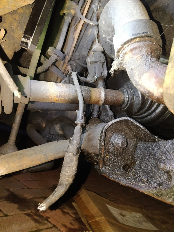

And another one behind the front driver side wheel just hanging over the driveshaft, looks like the connector has been cut off and taped up. Once again I'm unsure of what is was supposed to be for and why it's in this condition
