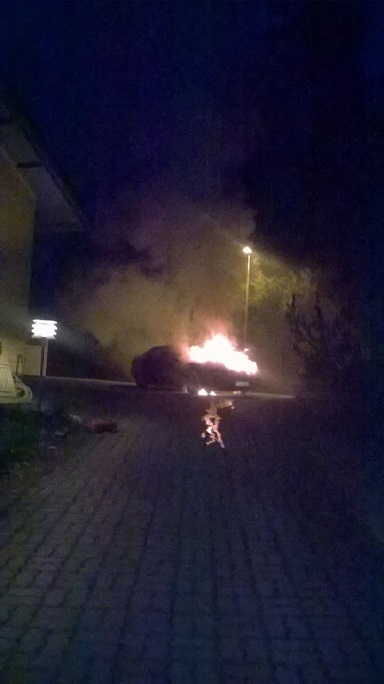

Re: 1989 XM V6 - New Member
From my own experience those fuel lines are not that bad, but from a few examples I've seen the fuel lines in the V6 engine bays are always in worse condition than in other engine bays, I guess it's because of the heat. Mine occasionally leaked from the fuel rail under the engine cover.
I have also heard of a few close calls and here is a picture of a not so lucky 24v Series 1.
http://www.sitruunapatonki.fi/forum/dow ... &mode=view
Was that image a V6?
I don't know if the original hoses are Ethanol compatible, so they might be degrading as a result of petrol now containing Ethanol.
