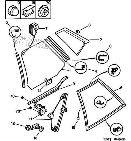

The door seal membrane can be just a single sheet of builder's polythene, gaffer taped in place, and pierced/cut where needed.
Haven't yet managed to find 95 291 417 "Door window guide".
NFP and not on Pieces de Rechange.
The same part is on all four windows, FF & RR, S1 and S2.

Part 7 in this.......

Not sure if the dealer can still supply the guide clip, which might fit other models as well.
Obtain a clip, or drop glass from a car being broken.
The membrane should be waterproof but foam lined for sound deadening and to ensure it doesn't rustle against the door card.

The clip is XM I & II only (no other Citroen models).
There is a closed-cell (impermeable) thin cushioning plastic available, sometimes used for padding/wrapping, and about 1.5-2mm thick. Slightly stretchy and shiny stuff, and easily torn. Unsure what it's called. 500-grade polythene will not allow rustle, and the door card is already good at soundproofing.

Window fixed (for the time being) with a cut down plastic raw plug and some PU Adhesive....we shall see.

Nice fix on the window guide, which is after all only a nylon block.
If the rawlplug proves to be too soft try making a block from Hdpe...milk carton.
As the repair is on the drivers window, it might be worth swapping it with one that will rarely/never be used.
