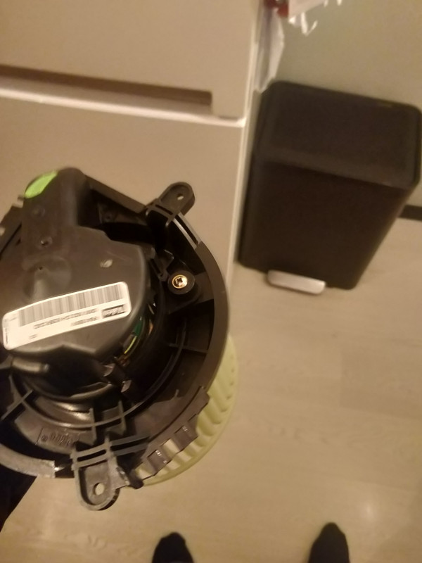

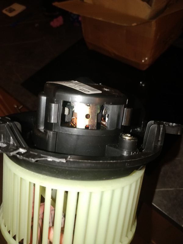

Picked up a xantia blower today and I got a few questions
It doesn't have a blower control module like the xm blower, is it built in? In which case how should the wiring go?

Not all Xantia blowers had a control module. Cars without A/C just had a tapped resistance and multi position fan speed switch. You probably have one of those, I think that they were also a less powerful motor.

As wired a Rhd Xantia blower will rotate the wrong way for an Xm and the centrifugal fan blades are reversed, so not much air will flow.
The blower motor is just a motor, the speed control circuit is an external item, so could be fitted to any suitable motor.
I wouldn't think any output reduction would be an issue, as the Xm has very good airflow and the fan very rarely runs at maximum speed.
