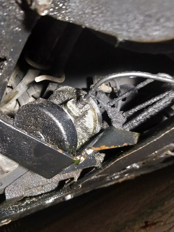

Post by Themasteryeti » Tue Nov 11, 2025 10:15 pm
Well spent another 3 hours tonight fettling with the oil pan and got it wedged in but still not quite there, got irritated and headbutted it out of anger and it suddenly popped into place! Not the most conventional method I'll admit but it did the job so I won't complain! And can happily confirm it no longer leaks oil!
While under the car I did notice this bit was also weaping lhm, what part would this be? Image
