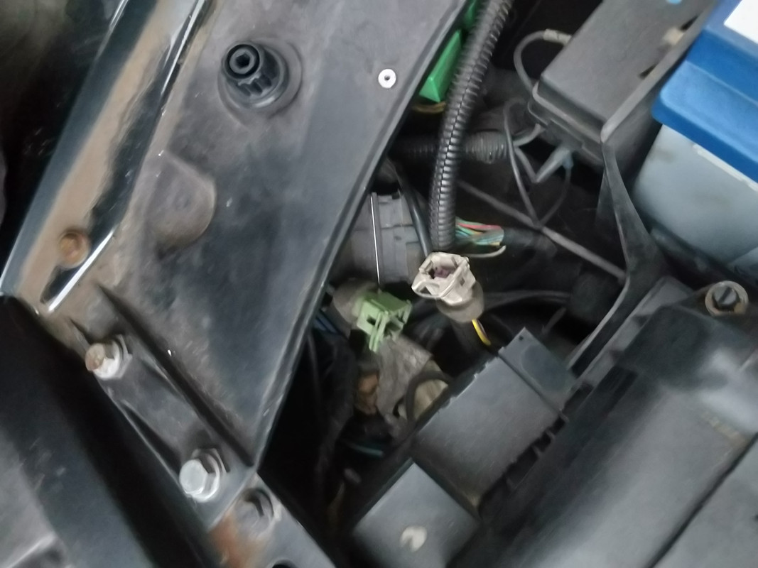

Also I've noticed some plugs on the engine bay by the left headlight that don't go to anything? I take it these are just used Ina different spec? Image

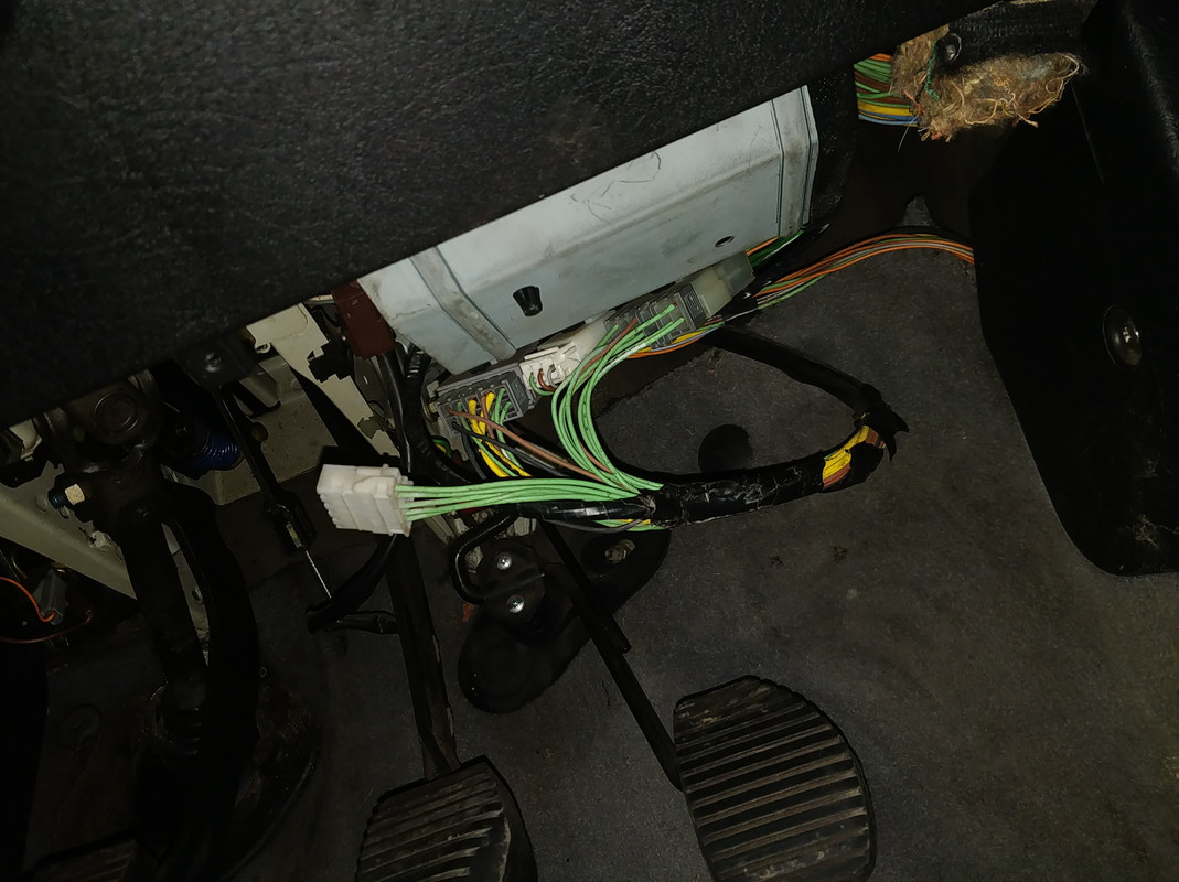

Also noticed the same under the dash, I assume the same, it's just used ina. Different spec Image

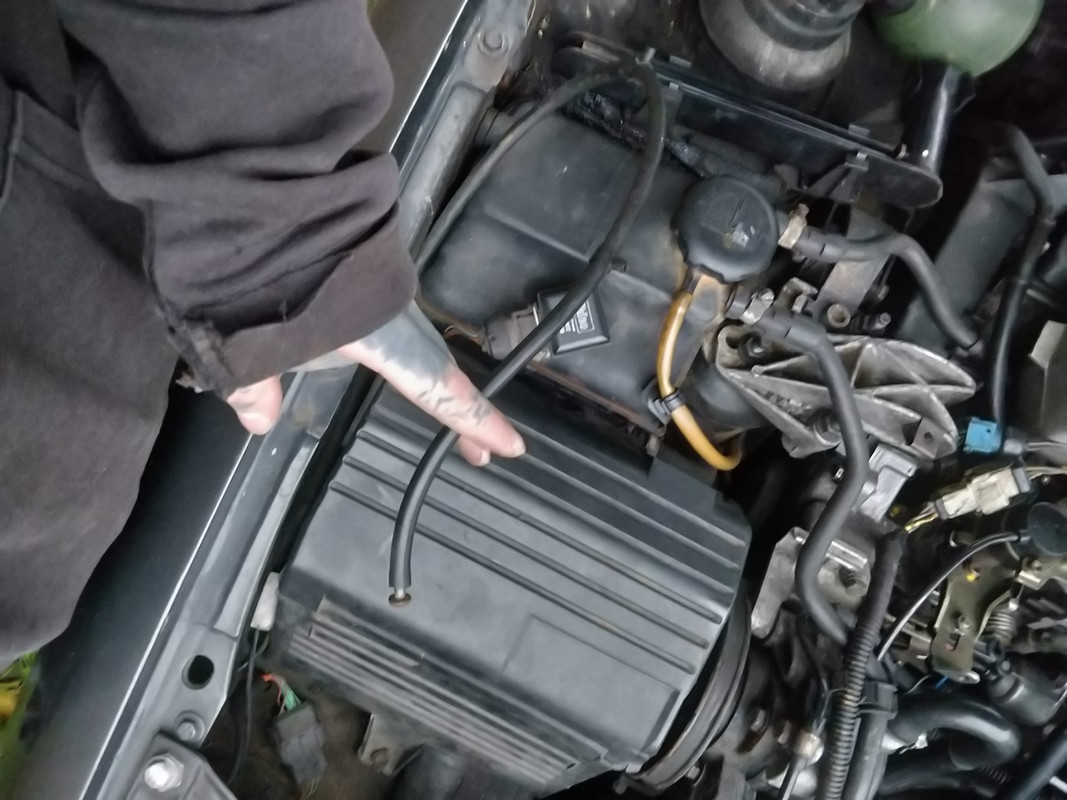

Also noticed this pipe in the engine bay with a screw in the end? I can't tell what it's for or why there's a screw in the end? It just disappears into the body work Image

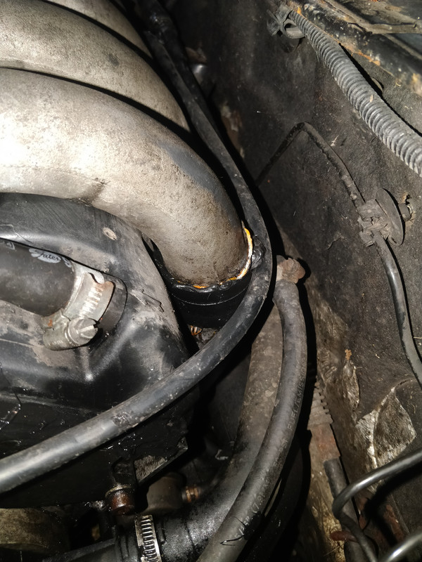

Oh and I don't suppose you know the part number for the seals for the intake pipe? Previous owner has caked them in silicone too instead of fitting new ones Image

The pipe with a screw most probably is the vacuum pipe that goes to the EGR valve.

Spare connectors are just or different equipment.
The plugged pipe, as stated by Tigerhunter, is indeed the Egr valve vacuum pipe. You may hear the pump running in the right wing.
Rubber manifold collars P/# 0362 55
Member Gasa, sealed his using worm drive clips round the top and bottom of each one.
