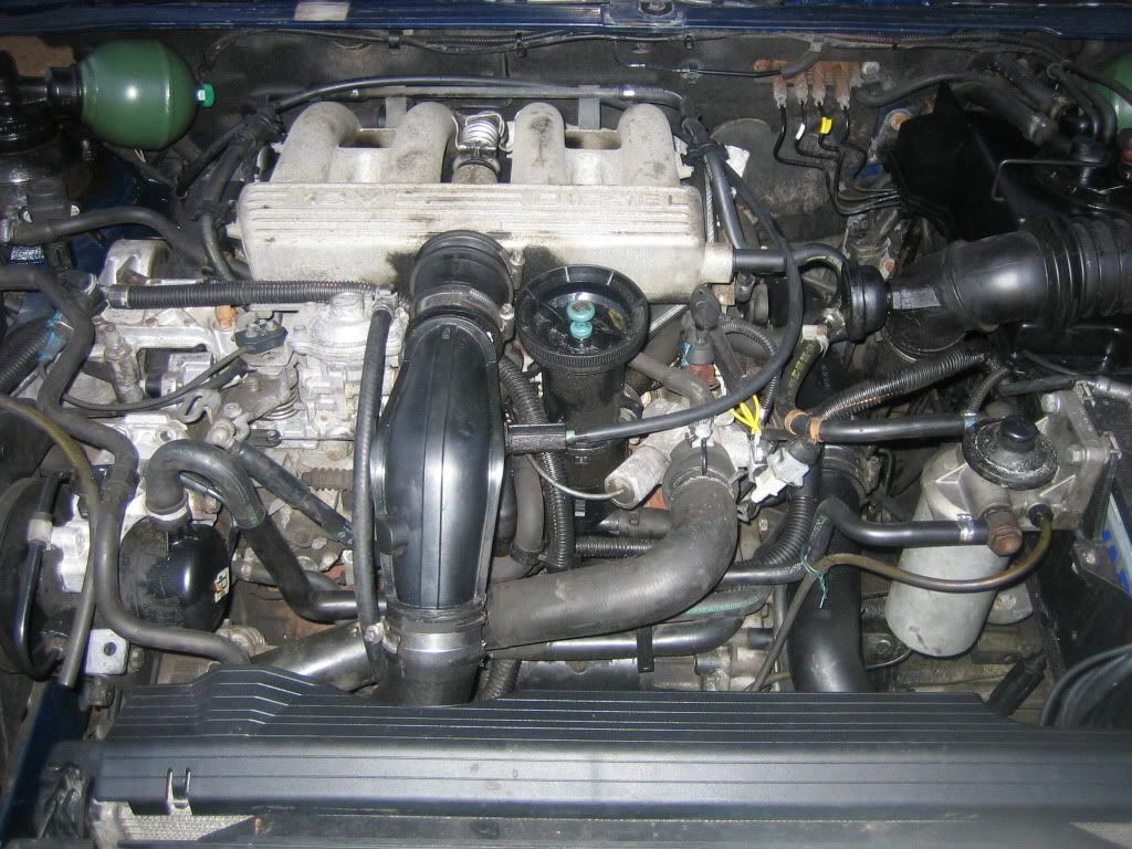

Re: 2.1 Autos- are they really that slow?
Post by robert_e_smart » Sat Aug 18, 2012 1:24 pm
For the Record.
2.1 Lucas Mechanical
2.1 Bosch Mechanical
2.1 Lucas Epic
