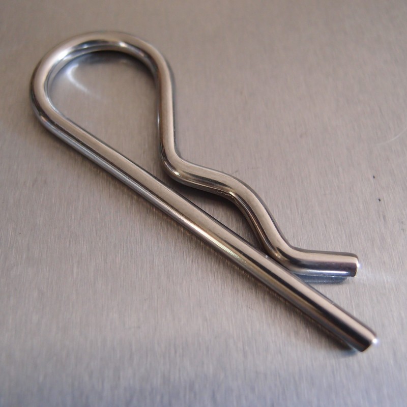

Re: Rob Draper's White Si 2.0 Automatic J645BYA
We should all be fitting these now, not that I want to rub any noses but both my struts are wearing stainless R clips and Roll pins.
Nice shiny bits! Unfortunately mine is not very shiny!Dean wrote:We should all be fitting these now, not that I want to rub any noses but both my struts are wearing stainless R clips and Roll pins.
Here you go
