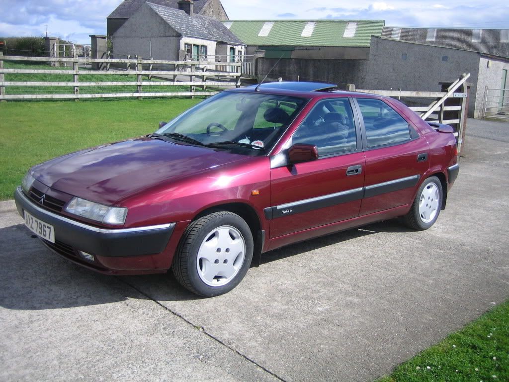

I don't think I did use the machine on the mandarin car, it had good paintwork to start off with, and was polished by hand.
One thing to be careful with the machine is not to hit the plastic trim with it.
The machine did a great job on this Xantia and Xm estate.

Robert...stunning efforts on the Estate and Xantia there.
