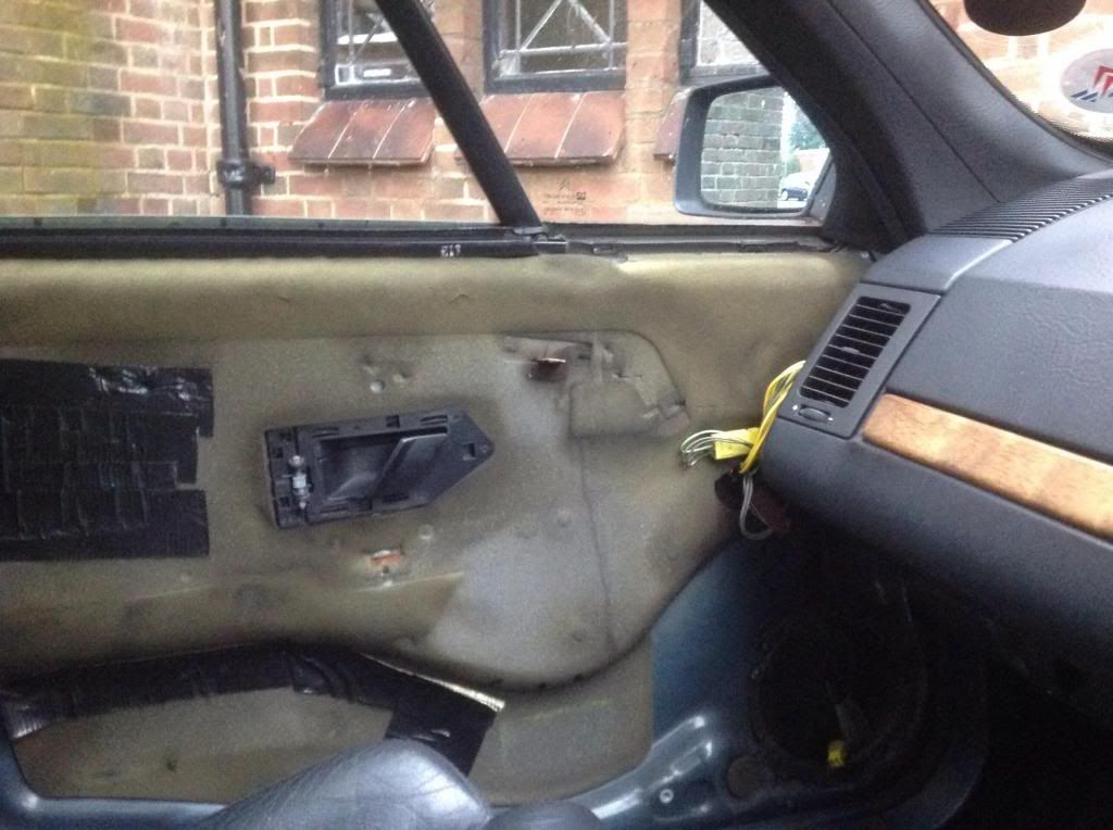

I decided to investigate this curious leak today. I have noticed water collecting on the door bin..coming from under the leather padding.
So for the first time for me...not the car... The passenger door card came off. Only casualties were one tab which had been glued back before and the speaker connection disintegrated!
Pics below to what I found. Unfortunately I haven't the foggiest how water is getting in. I can only guess it's via the weather trims on the window, and it is trickling down inside the door and then getting through a gap somewhere. The sticky plastic and foam are firmly fixed to the door, yet as the photos show, there is a drip.
Anyway halfway through, it decided to thunder and hail, so I was trapped in the car. But watched the area that is getting wet to see what happens. It did get a little damp, but not soaking. So to try and stop it from getting into the car, I simply stuck a line of duck tape so the water cannot get in or at least rot the leather or door card. Only time will tell to see if it has worked.

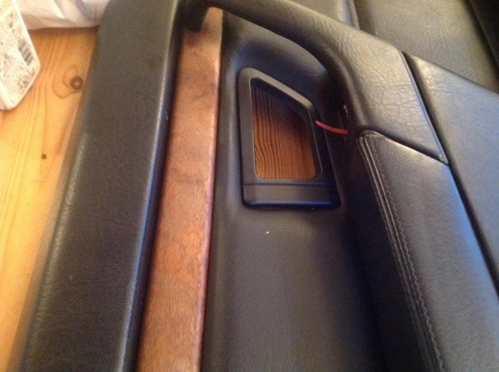

Another thing that was bugging me, ever since I got the car, the release handle trim never fitted flush like the drivers side. It was always half hanging off. So I had a go at fixing that. Oddly there were no broken tabs or clips, just over padded poorly trimmed leather. So I doctored it and hopefully it will all fit back nicely. Gave the leather and wood a a clean and polish up too.

That water will be coming in past the window guide seal for the fixed quarter glass.
Re: Russ's 2.1 SED Auto
It could be, what's interesting is it just appears in the foam by that bracket for the door handle. It is not running down from the window under the plastic/foam wrap stuff. That is welded to the door!
It must be tracking down inside the door. I sat in it watching it like a hawk today in a thunderstorm. Nothing really to report. Foam got a little wet. That's all. ERGH, hate water, gets everywhere.
Russ,
While you've got the door trim off, might be worth rigging up a garden sprinkler, and sitting in the car to see what happens. Then again, with current UK weather, any day would do...
Also check the main door-surround seal?
The door/window exterior lip seals do get a bit hard over the years, but even so, water leaking past one of these would, I'd have thought, simply find its way inside the door, not inside the car. Quarter-light could well be the problem.
Oooooer. Don't fancy a fish tank as an interior Chris.
It's not the door trims, or seal. It has to be the weather strip at the base of the windows at fault. Where the drip mark starts on the foam, is where the damp appears. No other signs of it dripping onto it. It definitely is getting in from inside the door cavity, behind the foam. Most odd. Although it looks like there is a cut line around that shape in the foam, the plastic adhesive stuff is firmly stuck to the door with out any tears.
No need for sprinklers tomorrow, the natural one will be on most of the day...
