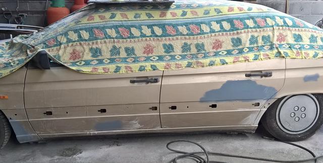

Re: Gold 2.0Si
That will look great once done, Neil.
Those sills are in surprisingly good condition. Have you had any significant rot to deal with?
- Posts: 1247
The outer sills are in very good condition but the inner sills and floor have had to be rebuilt. Having said that since they were ripped apart and done properly from scratch they haven't needed doing again. The underneath still looks pretty good after being taken back to bare metal a couple of years ago.
In fact the body panels are all very sound and the paint has held up well considering it's nearly 30 years old. Any real rust has been found behind rubber seals, trim, badges and lights hence why I still need to remove the door handles and mirrors and the front and rear bumper trim, though where the latter fixes is not apparent.
