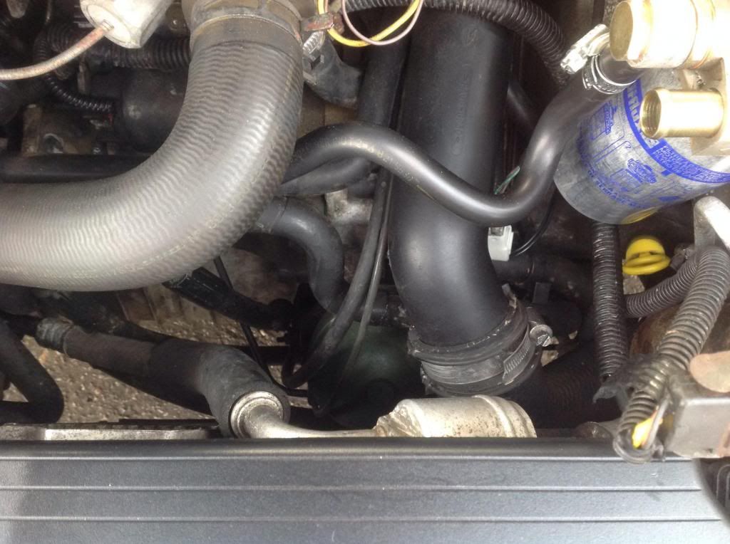

Post by russ92xmsed » Wed Dec 11, 2013 3:03 pm
This is more for Jim!! Not as much space as I remember. But hopefully it is enough....
Posts: 15102
Re: Russ's 2.1 SED Auto
Post by Dieselman » Wed Dec 11, 2013 8:38 pm
On a 2.1TD you have to access the hydraulic pipes on the regulator from underneath.
Post by CitroJim » Thu Dec 12, 2013 5:22 am
Excellent Will :) I was worried if the regulator was functionally inaccessible as it was on my old TCT Auto...
That looks a lot more open and accessible...
Post by normantilbury » Thu Dec 12, 2013 9:32 am
When Plaides replaced my regulator Martin did it from underneath when on the car lift.
Norman
Post by russ92xmsed » Thu Dec 12, 2013 12:56 pm
Excellent! There is more room underneath... but I was taking a pic with the iPad, whilst doing fluid checks....it has no flash, so hence the above shot...albeit useless. :lol:
