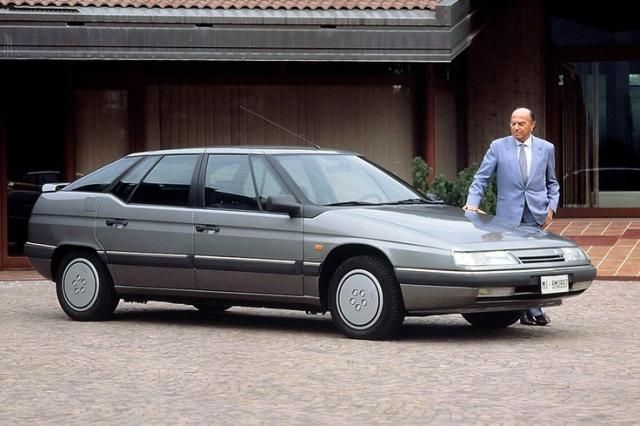

Ill stop fixing it up when mine looks like this 8-)

Have you got the pale blue suit Vince....
Re: Vince's xm - The welding is underway
Post by Vince » Sun Sep 07, 2014 10:00 pm
Not yet Russ but ill be looking on ebay :lol:
