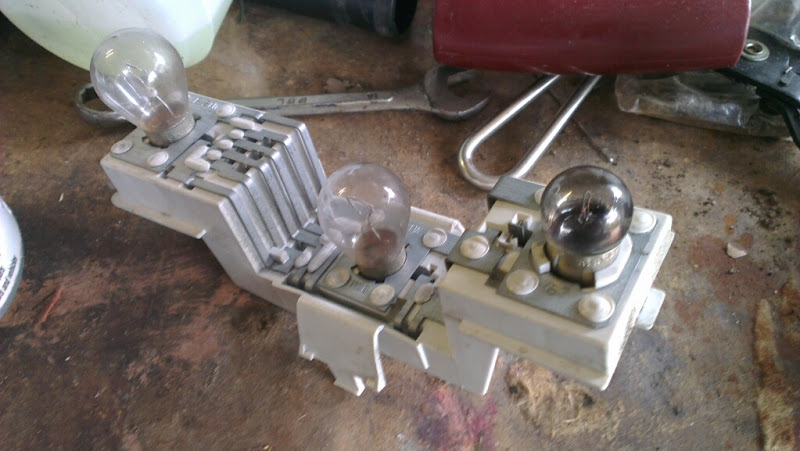

Tailgate lamps out for inspection
Bulbs cleaned, contacts wire-wooled and smeared with copper grease
Other side. Replaced the about to die sidelight bulb with a random one I had that fits

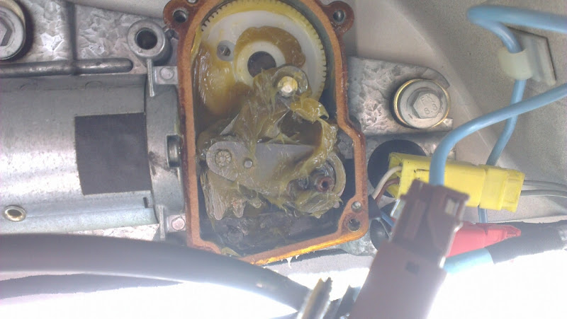

That done, I removed the 9 torx screws and dropped the carpet down from the tailgate. Every moving part got a good coating of plusgas
No befores, but this is the rear wiper motor. All the grease had stuck to the back plate, so I smeared it all over everything again. Can't hear the ting now, could hear it before!
