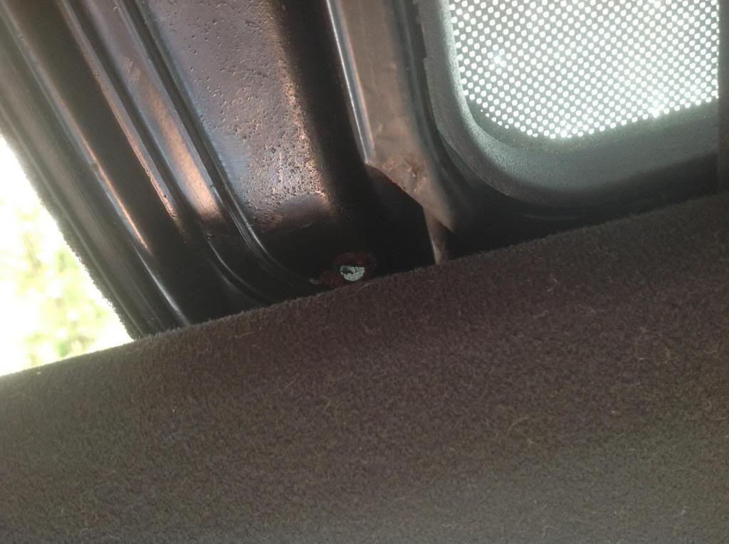

Look what I found. I assume it isn't meant to be there! :evil: I had a look at Will's sunroof reseal thread and I cannot see a hole on his like this. So I can only think it isn't meant to be there. If so, I will bung it up for now and treat it later when I have the time. For now, I have used some very strong water proof tape used on dinghies to seal the well seal! ;) so hopefully that will do for now.
So now this afternoon I have to strip the interior out on the drivers side, cos I have found sodden sound deadening!!!! GRRRRRRRR! :roll:
At least I have found it and can get it dried out.
One thing to the next. :roll: :lol:

Post by Dieselman » Sat Sep 14, 2013 1:09 pm
That hole is due to the bonding leaking water.

Post by russ92xmsed » Sat Sep 14, 2013 1:31 pm
Thanks Will for confirming that. :D Precisely what I thought. I will plug it up temporarily and then sort it our after I get back from Amsterdam.
Well the interior on the drivers side is out and the floor was wet. No swimming pools, but it couldn't be left. I cut the foam out and also....and I am ashamed to say this, the carpet. but in my defence, once it is all back together, the cuts should be very well hidden.
It means then that I can really dry it out and not have to take the entire interior out. It is going to be filthy tomorrow, so one I can keep a beady eye on water ingress, and two it is quicker. Time is of the essence!

You want me to hang on to a nice grey carpet series II :) or foam for that matter...I don't understand that hole at all, it is not rust is it

Post by russ92xmsed » Sat Sep 14, 2013 3:30 pm
:lol: thanks Jaap, but I think my carpet will be okay. The foam is drying in the bath! :lol: the carpet is almost dry already.
I cut it so it won't be visible and obvious.....the glue that holds everything together is soooo sticky. It should all stay in place.
The hole has been caused by rust. The gritty look is actually WD40 with dust and muck in it. Not rust.
And to me, this has only recently appeared too. I was slightly dubious as to what it initially was, as the hole was almost perfectly round, like a screw hole. But then why have a screw there....
So what has happened is the sealant bond between the metal fame and the glass has failed somewhere and water has collected in the frame and rotted a little hole.....and right over the corner of the headlining. So no wonder it was wet. So it will have to come out and be sorted out properly. At the moment I have temporarily sealed it all with tape. We're due some nasty weather tomorrow, so fingers crossed this will help to keep the water out.
