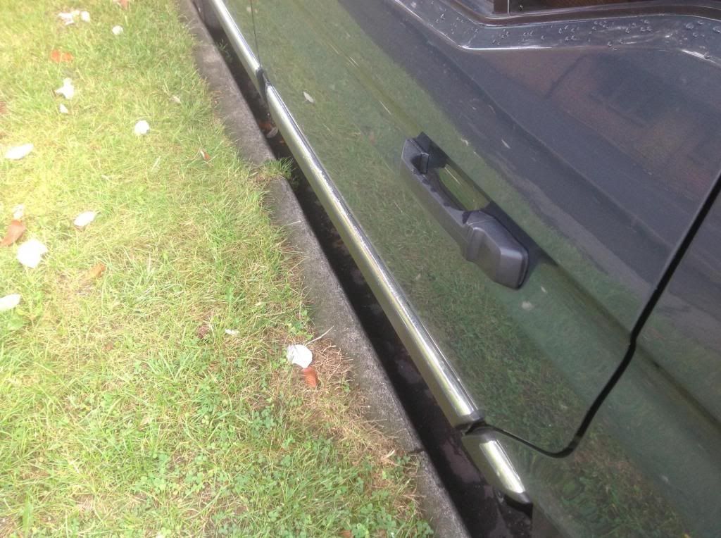

One thing I will say, is if your trims are smooth, as in no bumpy bits from corrosion, then it should work well. But you won't be able to do the bumpers. It just won't go round them and it is not wide enough for the corners.
So far they have survived two car washes and a lot of heavy rain and they haven't peeled off yet.

This is for Vince....pics of my 'Silver' trims!
Sorry not the best pics in the world, but they are shinier than that!

Wow Russ that trim tape looks good. ..does it just stick over the top? Cool H van!
Re: Russ's 2.1 SED Auto
Yep... it certainly does. I cleaned mine with water and washing up liquid first to get rid of the nut oil I had been rubbing into them. Then used some clutch and brake cleaner to really degrease. Then on it went.
