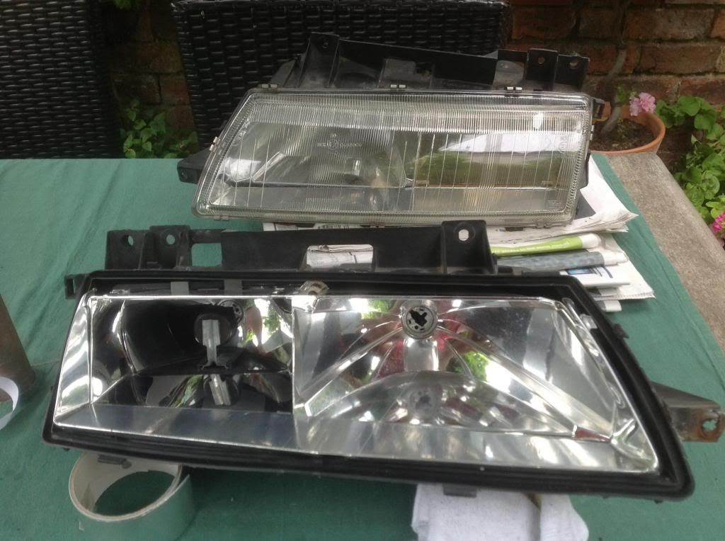

On Saturday, I set about cleaning them up ready for swapping these new ones for my crappy ones.

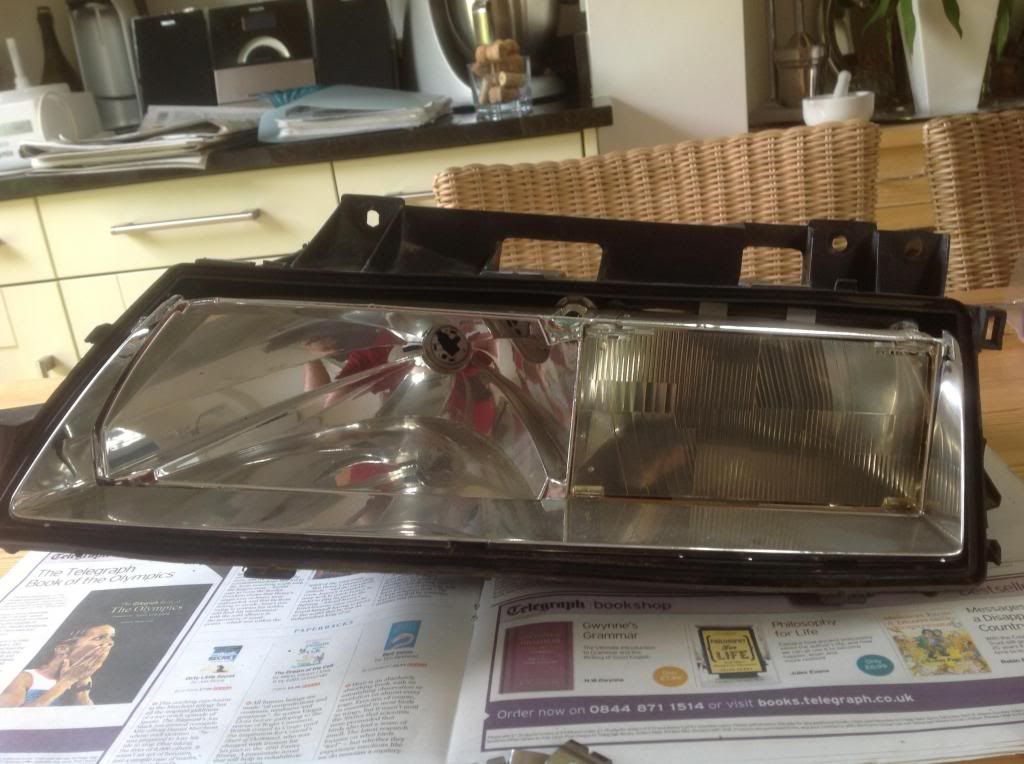

Although Matthews lights were much better, they weren't perfect. I was extremely careful with the silvering, very delicate in places and in some areas it was bubbling and flaking off. However a good clean has done wonders. On the flakey bits, I ...and I am not really proud of this....used aluminium tape. A bit of a bodge, but it at least sticks very flush and of course has a good reflective finish. Infact you have to look quite closely to see the joins. But it will do, there really isn't any other cheap solution. I intend to fully restore my original headlights with some special and expensive paint. But that needs more research. In the mean time, these new lights will do nicely! :D
The Headlights
They wouldn't be XM headlights without a bit of yellow lens action!
Light dismantled, ready for cleaning and repairing the flaky bits.
Light restored

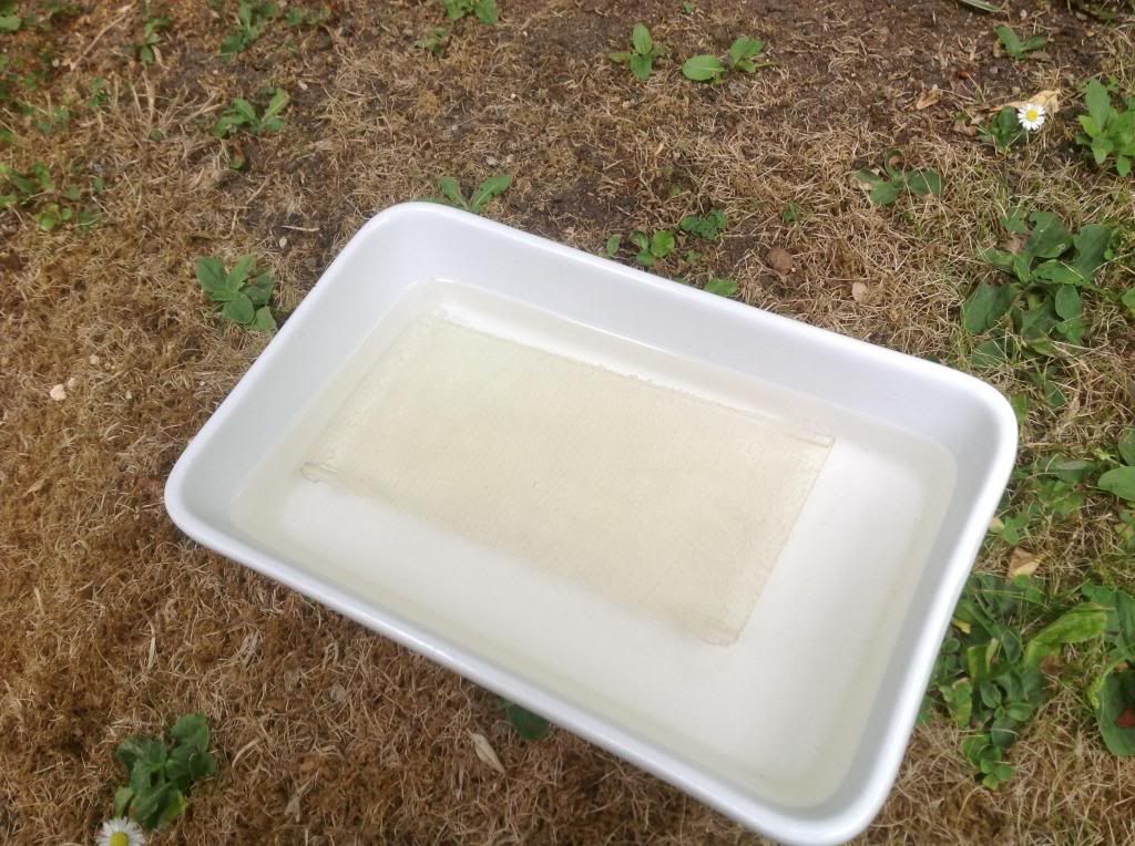

Soaking the drivers side lens in two scoops of powder, dissolved in water, and left in the sun for 6 hours. The UV light helps with the reaction.

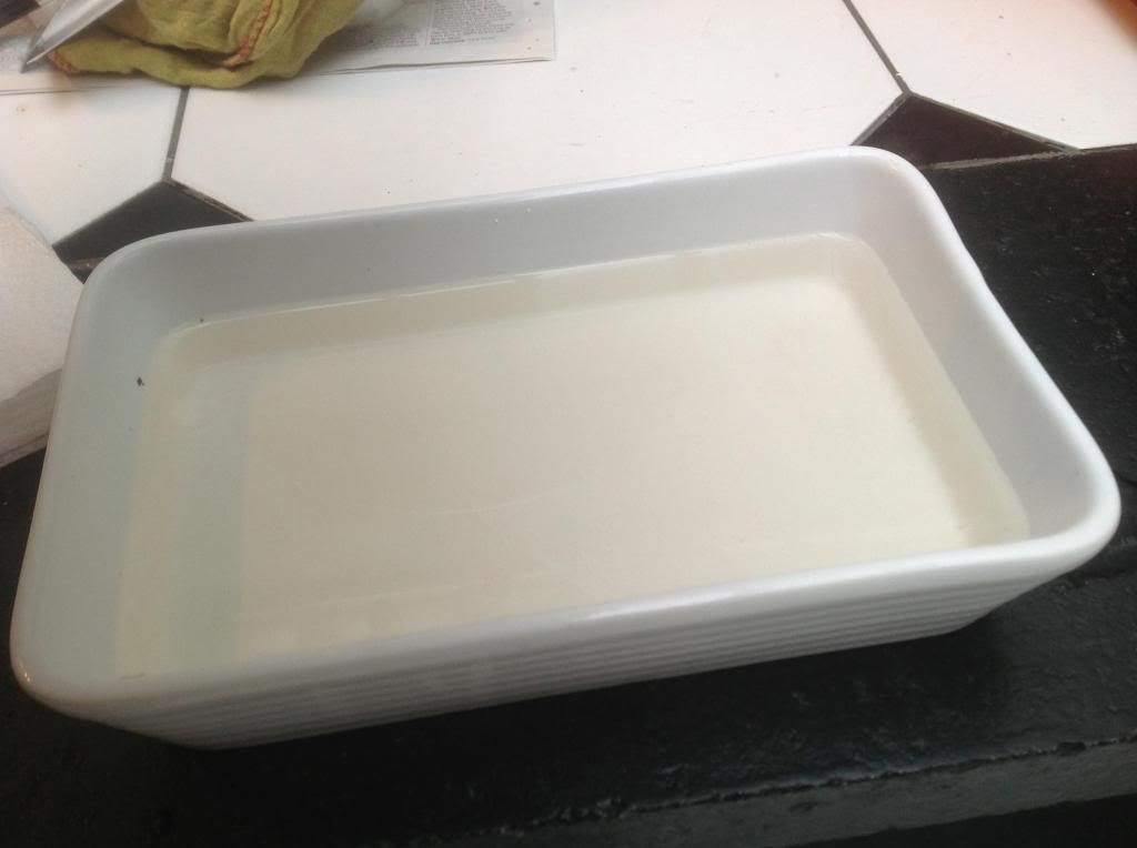

This is what is left in the water after 6-8 hours. It is clearly yellow.

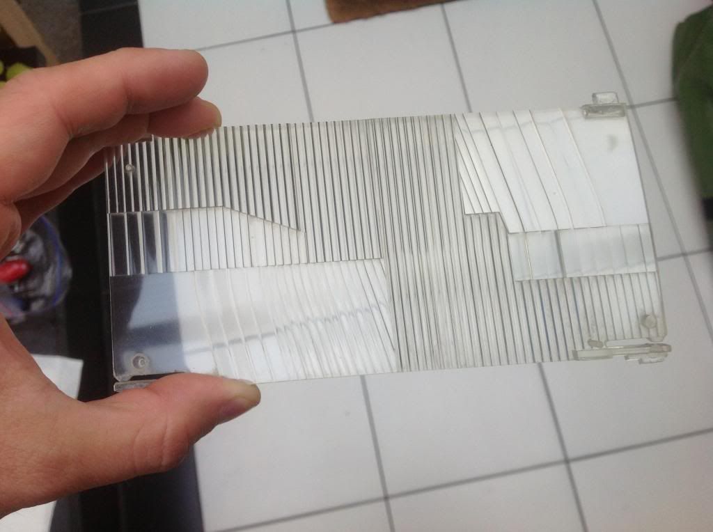

This is the lens cleaned up and polished. I had to repeat the process 3-4 times. You know when it has stopped working as it won't bubble and fizz anymore.
I used a spot of rubbing compound and then polish to clean up the lens after treatment.
It doesn't get rid of all the yellowing. But it certainly reduces it.

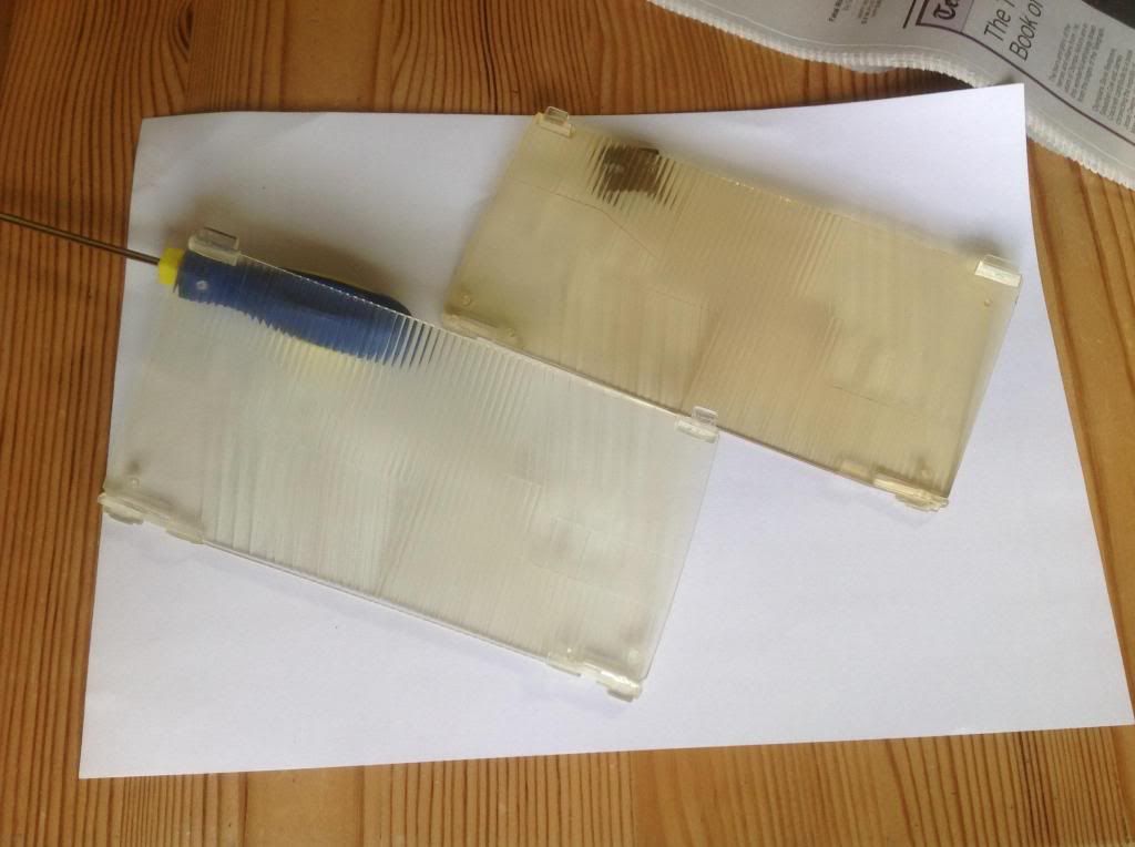

The two lenses side by side. One treated twice, needed two more soaks....the other one original.
Already there is a significant difference.
After that initial success, I repeated the same restoration on the other light. This inside was better than the other side. But the lens was worse.
At the moment it is in it's last soaking treatment and is now the same clarity as the other one. I need to polish and clean it up further. So will post the results soon.
