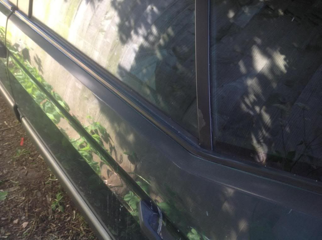

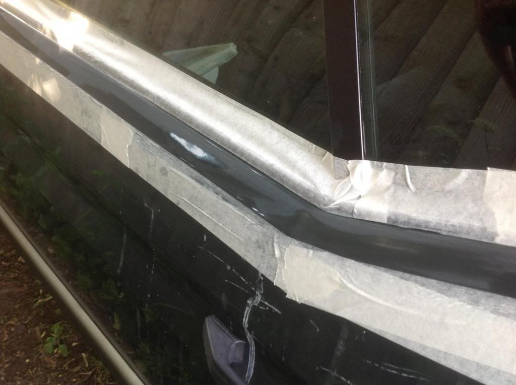

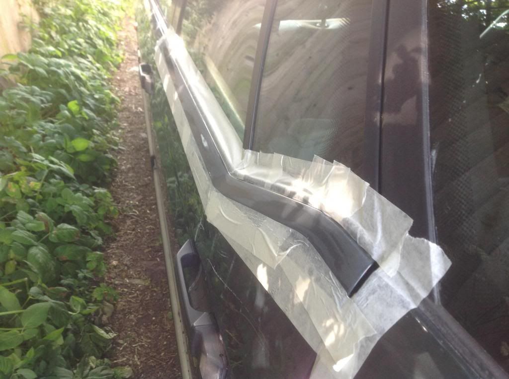

A very productive day today. I took advantage of this amazing weather and did some more body work.
I had started to sand down the shoulder line of the passenger rear door. A patch of laquer had started to flake away and looked really awful. So with the correct paint in my possession, I sorted it out.
Some pics.......
Sanded down and masked off.
Whole surface masked off ready for some primer.
All finished. Needs flatting back with somme 1500 wet and dry, and some rubbing compound will turn the clear coat all nice and glossy.
You can also see that the masking tape took some black paint off the door pillars. I also tackled these today with a proper sand down and a coat of etch primer then satin black. Halfway through that lot.
