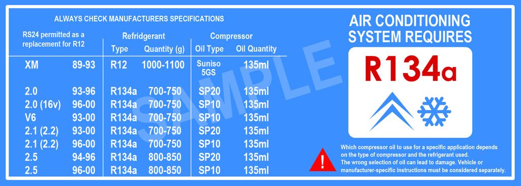

Indeed you can but system pressure is relative to some degree to the gas you use, what you really need though is oil weights, there should be a chart that shows how much oil sits in each component so after you have swapped said component you know how much you have lost, that's really why I've got to flush mine, I have no idea what oil is in it and how much since the drier will need changing and its had a new condenser, to much oil and the pump gets slugged, too little and, well.

Thanks ChrisWhite Exec wrote:Dean,
RS24 (R426A) does seem to get some good write-ups. It's also US EPA approved for retrofitting to R12 systems.
Try this for a listing of both R12 (and oil) and R134 (and oil) for all the XM models...
http://www.autototal.ro/dmdocuments/Cat ... 0Hella.pdf
Behr-Hella are pretty trustworthy.
C.
I've seen ac engineer forums say its "leaky" and doesn't hold too long (small molecules?) But they say that about 134 too so not sure how true it is, don't know what weight of charge it needs also which will effect pump loading.
Re: My Citroen XM Prestige
This site says that RS24 needs a charge weight of 40% of R134a, and 35% of R12...
http://www.duracool.com/-faq.html
