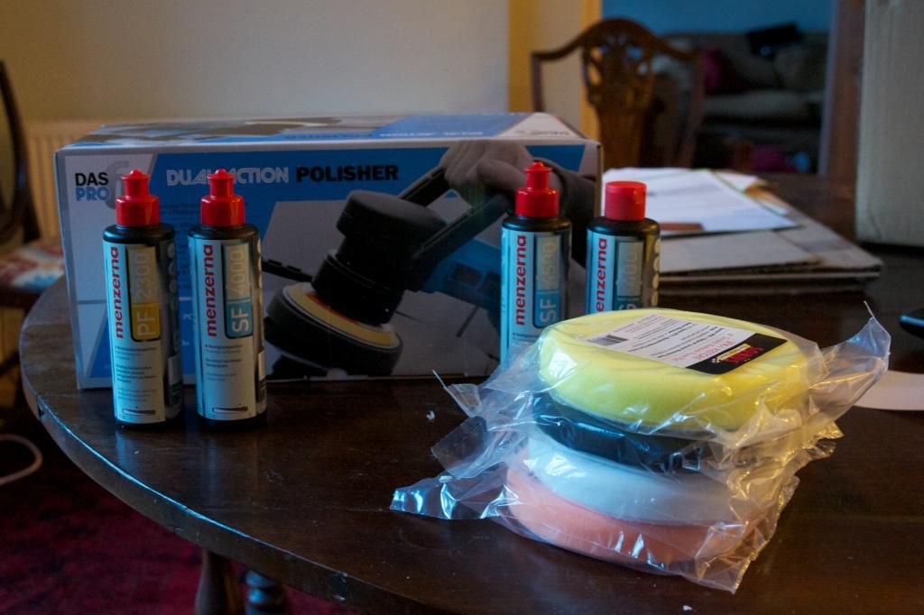

Remember the golden rule Charles......start with the least aggressive combination and then step it up bit by bit until you find what works then you know what works.
Id start with a medium cut pad and a light cut polish...If that doesn't get the results you want then you can repeat the process with the same combo (make more passes) or step up a notch with the polish keeping the same pad. You shouldn't need a heavy cut pad...Keep in mind that freshly painted surfaces don't fully cure/harden for 2 to 4 weeks ;)
Its a process of doing test patches and discovery :)

Kit turned up today, precisely two days after ordering. Most impressive.
The intention is to have a model XM rather than an XM model!

Nice looking kit there...

Great choice of machine and products Charles ;)
Remember that Menzerna polishes need to be worked for longer than say Meguiars products to make sure you don't end up with any holograms imparted into the finish...
Finish whatever work you've done with the final finish pad and SF4000 Menzerna polish....Absolute perfect results can be obtained with this as a final step :)

A little test to remove some overspray with the Menzerna fast gloss and the Sonus scratch cutting pad came up a treat. So a good, if small, start!
