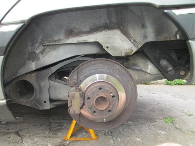

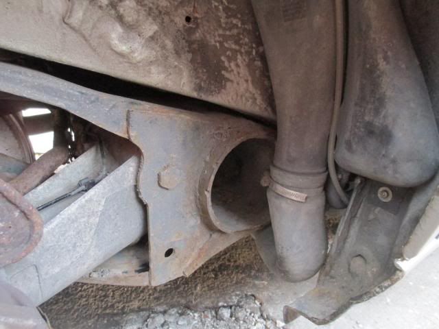

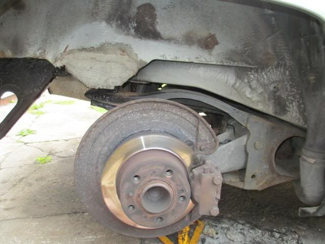

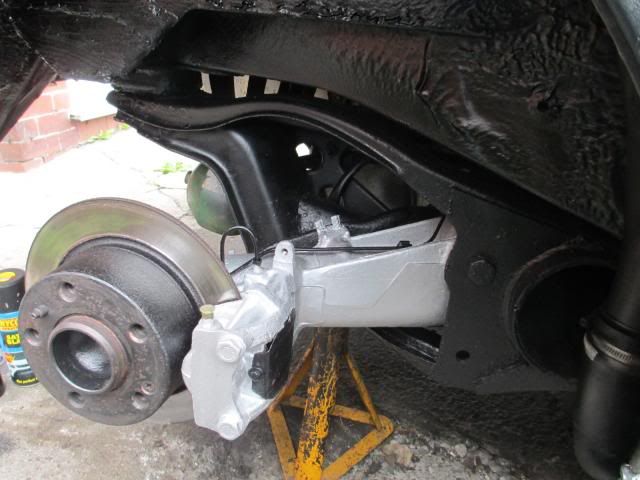

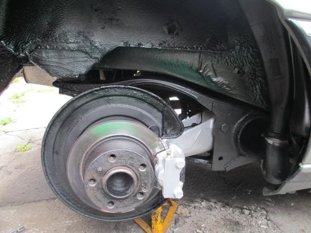

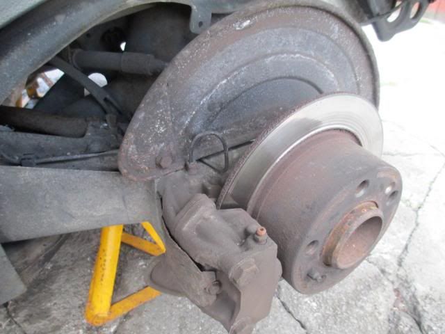

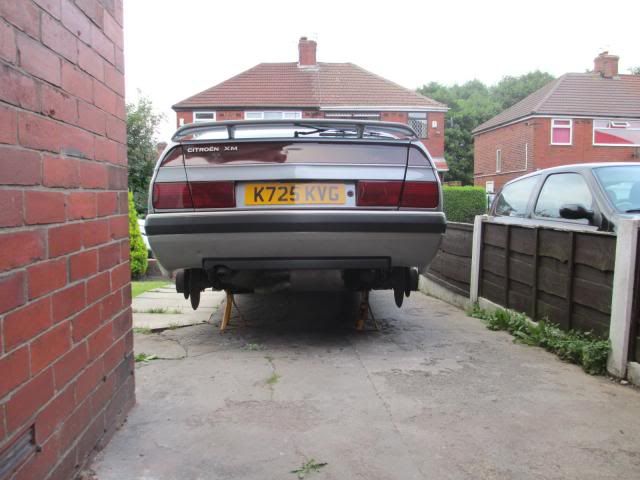

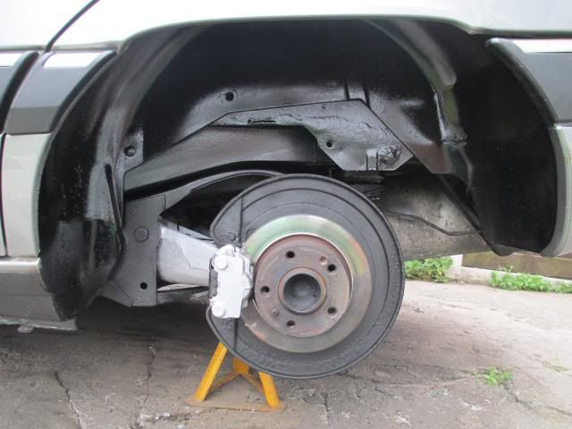

Ive been cracking on with the xm and last weekend I managed to get both rear arch sections completed in one foul swoop. I must say im happy with the condition of everything. Nothing with any worrying rust, sure one of the rear bumper brackets is gone, but I plan on taking off the rear bumper at some point anyway so I can make a new one by copying the good one that remains...or something that will do the job ;) Here is how it went......

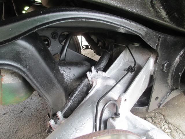

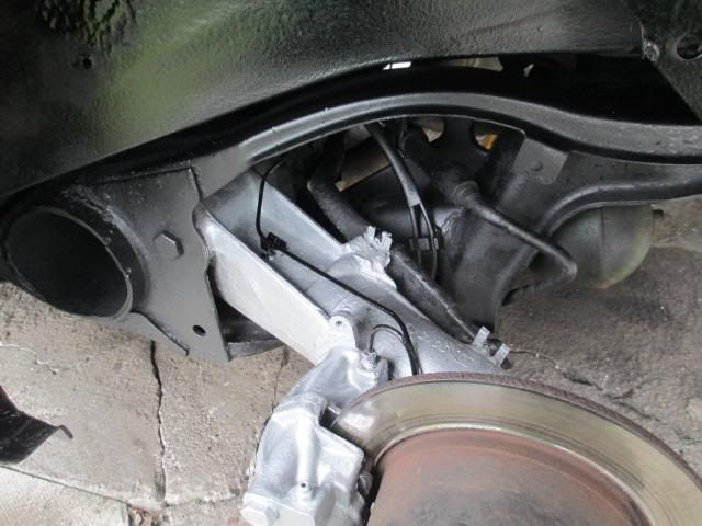

The process is straight forward if not a bit messy. Wash it off and degrease it. Once dry, wire brush as much rust off as humanly possible. Then start cleaning each bit and painting it to make it look better and protect its future.
The products used however are, tetrosyl underseal aerosol for up in in the arches behind the liners, black stone chip aerosol for the sub frame etc. as it dries smooth with a satin finish, a tin of satin black for anything else smooth that doesn't require the same level of protective coating, and I used simple aluminium wheel paint for the trailing arms and rear calipers. My engine bays have been painted with this for years now. Its very good as withstanding heat and doesn't chip off or discolour...at least not that I've found.
Spray the big bits and mask anything you don't want to paint, the smaller detailed bits paint with an artists brush (£3 a set at Tesco) using the lid as a paint pot. Just spray into it to fill your pot ;)
I find it quite relaxing just plodding on....its not Rembrandt quality, but its a pastime and the car benefits :)
