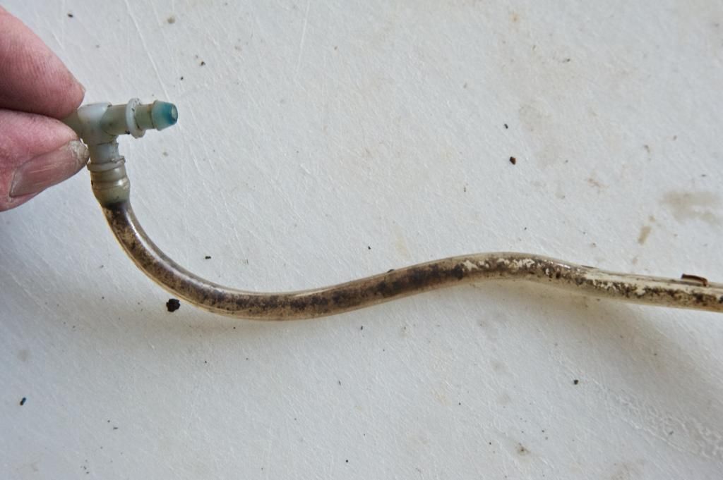

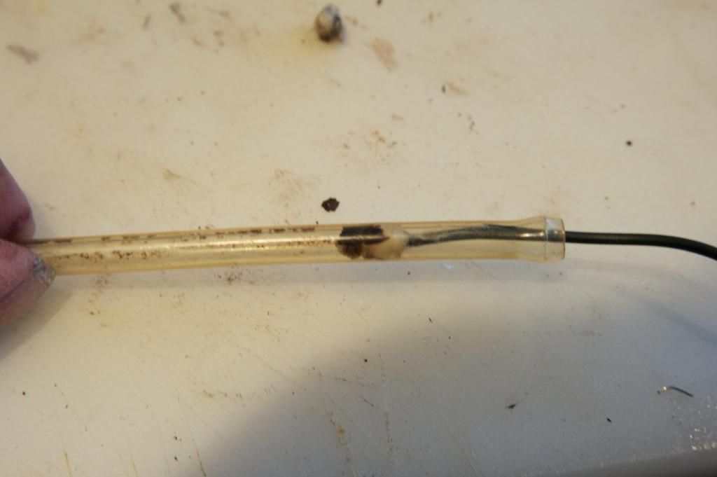

Heavy rain having just stopped play, my progress so far. Got the wing off and the tank was full of fluid, so no leak or broken pipe there. Black pipes through to the clear pipes all fine. The clear pipes somewhat silted up:
I left those in a milk pipe cleaning solution (it works on my cappucino maker!) to deal with the jets.

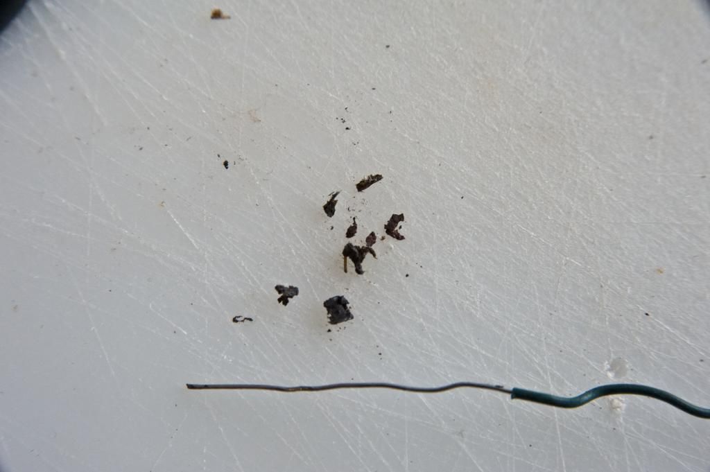

Blowing through the jets revealed the blockage there. So I removed both from their clear pipes, the plastic piping which joins the clear flexible pipe of one sheering off (old plastic now brittle) and using a stripped garden wire, just under 1 mm thick, to fiddle around in the jets I extracted a lot of gunk:

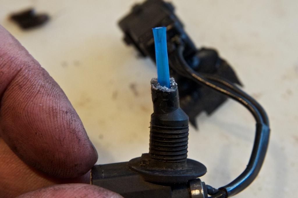

Finally, how to get the tiny part of the broken pipe back on - seeing the leftover blue plastic straw from the cotton buds - almost a perfect fit, so now splinted ready for the super glue. I'll need a replacement at some point.
