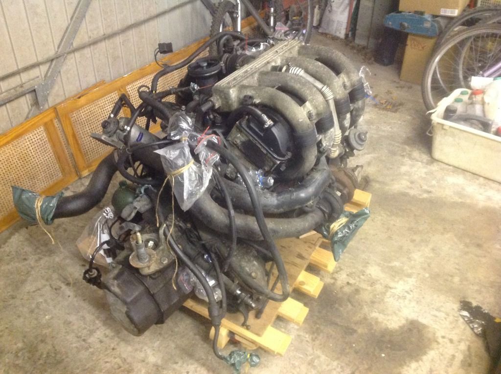

Post by russ92xmsed » Thu Mar 03, 2016 5:15 pm
Had a delivery today. Suppose that makes me 2.1 committed! :) :oops:
