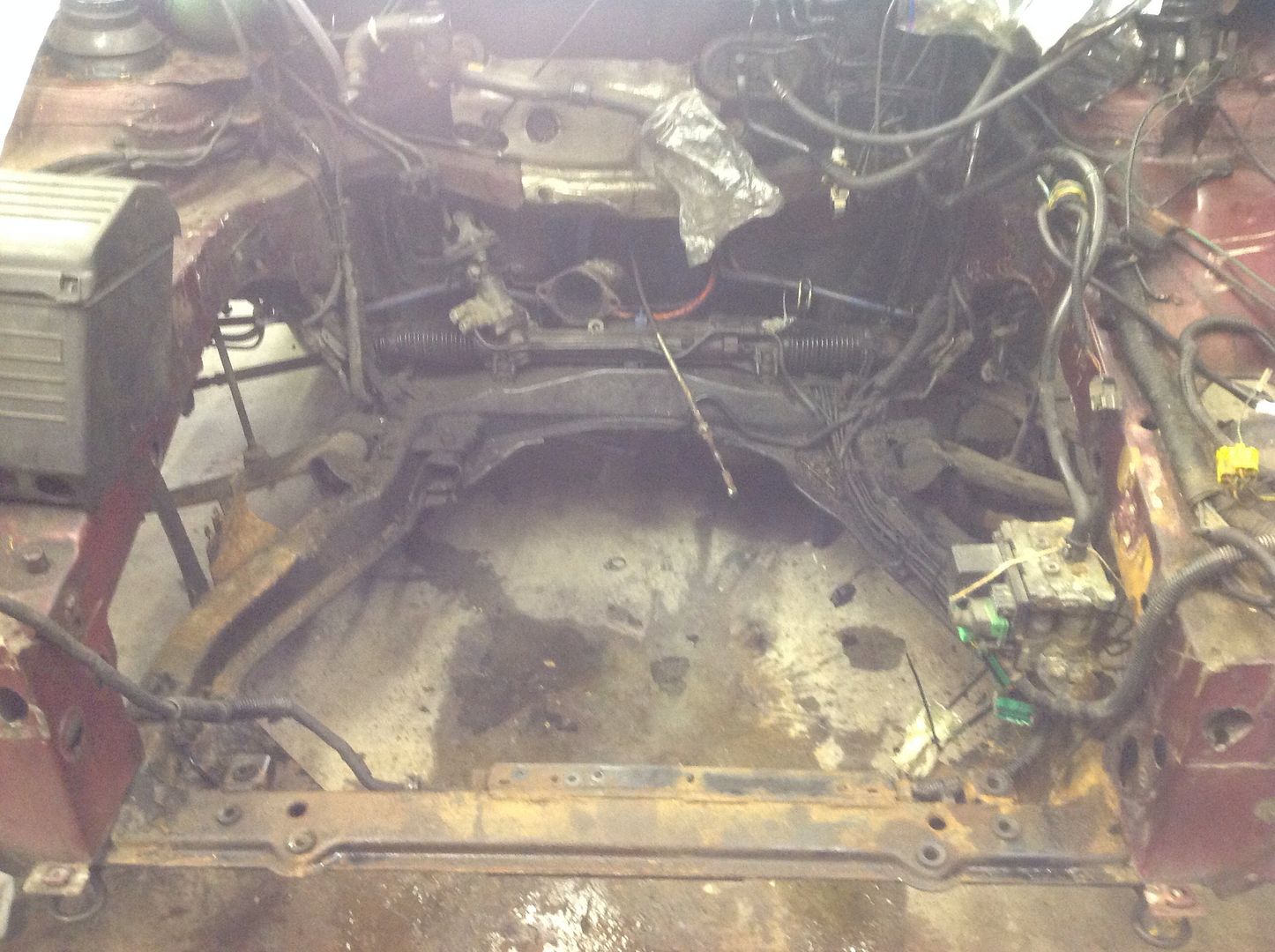

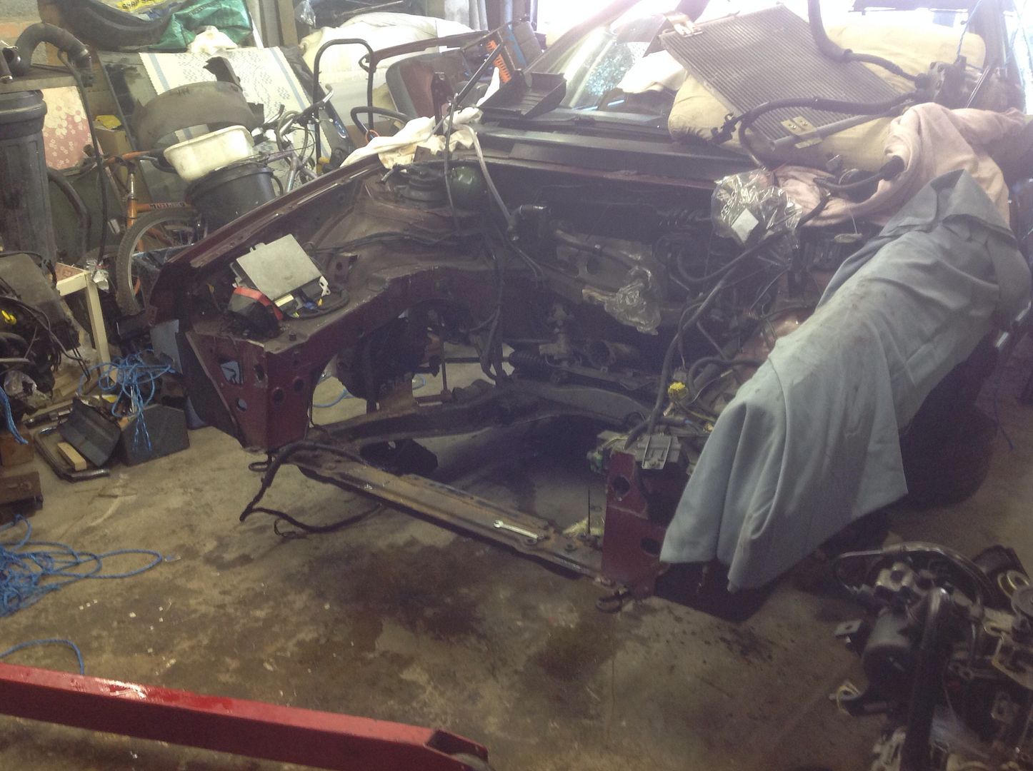

Today finally saw the engine removed. Little hiccup with the gear selector cable still attached via the small bracket. Whoops, forgot that. Had disconnected it from the gearbox, just forgot the two little bolts holding it to the engine.
But otherwise it was extracted without too much fuss.
Now the cleaning up and rust beating can resume... Not that there is loads. Subframe has been nicely pickled in oil and dirt. So is actually looking very good. Wondering if I should leave it alone!
I can also now get brilliant access to the spilt steering rack gaiter on the drivers side...which actually has split on the very outside closest to the wheel arch.
I need to order a new hydraulic engine mount. That's had it's days and is leaking a little. Otherwise, it's looking okay.
Not looking forward to putting the other engine back in.... But hopefully it will go smoothly.
