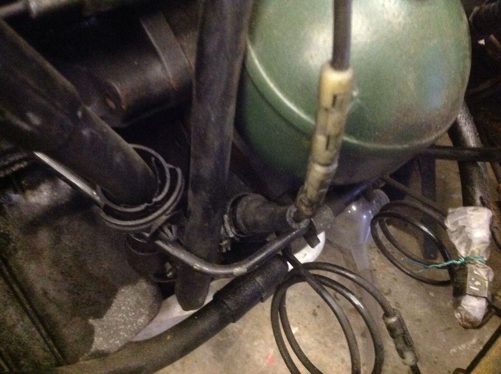

I have hit a small snag. Only minor but some opinions would be very much appreciated. I'm currently sorting out which hydraulic pipes that need to be disconnected from the LHM tank filter housing, which will be taken out with the engine and which will remain. It's obvious which ones go where...Ie pump feed pipe ect.
Now on my grey xm engine, I stupidly cut the little clear pipe at the tank end, that runs to the regulator.
On the mandarin engine it's disconnected from the LHM side at the moment, but I need to swap it over to the grey engine. This pic shows it's connection on the regulator. It's held with a worm drive clip in both engines, but I can't seem to remove it. Just don't want to break it. Is it best to simply swap the regs over, or can I disconnect the pipe.

You should be able to pull the clear pipe out of the rubber ferrule.
Excellent! Many thanks Will.
