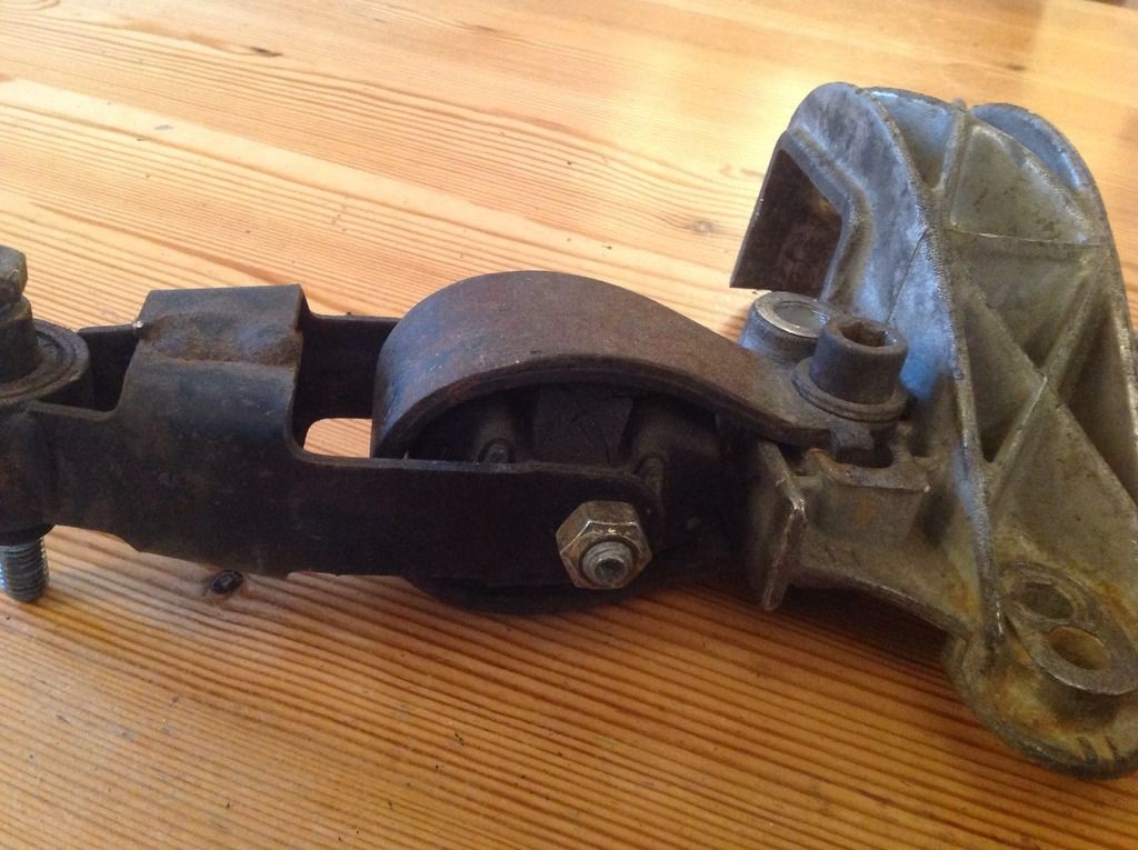

I finally got to my spare engine mounts and well it's not too good. They are both shot! The mandarins top mount is also perished.

Looks like available, Russ...
1846 55 Engine Flexible Bush
as well as
1338 72 Engine Water Thermostat BVA 80degC
1339 66 Thermostat gasket
...but check
as well as
...but check
Well that's good news. Thanks Chris. Just got to find it now.... If they are about....
