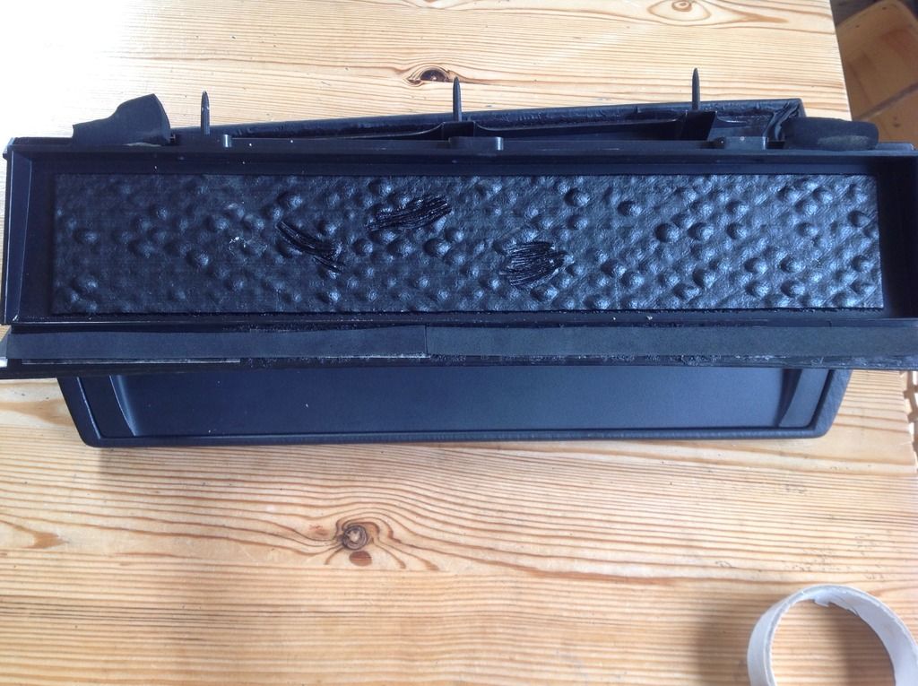

On my drive over to the X rally, the binnacle thought it would be a great idea to buzz nearly all the way there. Which for me was two and a half hours.
and yes it could be heard over music!
So enough is enough. And this is what I have done in the attempt to stifle the annoyance.
I have stuffed the lip cavity with a high density rubber foam packing. Taped in place. It wedged itself in nicely actually. This is where the main buzzing was coming from. I also placed on the bottom lip that tucks under the dash, a new strip of neoprene rubber. It's only a few mm thick, but that might also help to dampen creaks and buzzing. So hopefully this little bodge might do the trick. Will find out soon enough.
