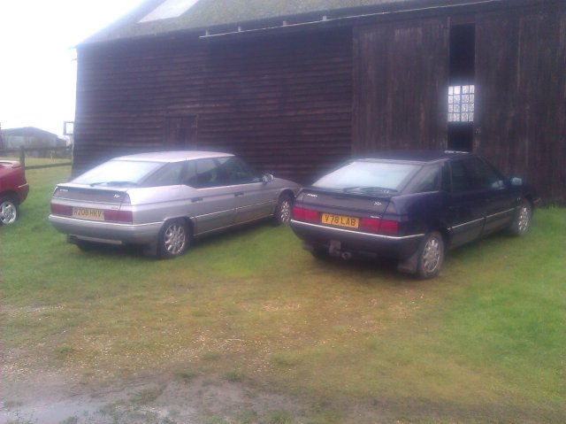

Here's a rare thing. Two ES9 V6 XMs together.... I apologise for the poor pictures, my phone camera is playing up badly...
Just in shot is an Activa and out of shot is another V6 - a Xantia V6...

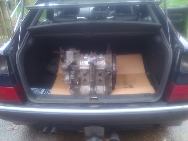

And here’s something even rarer... A Wankel-engined XM :)
All clean, devoid of all ancillaries and ready for the journey to my workshop...
We had the sump off of it today and found rather a lot of sludge and flakes of copper. This leads us to the suspicion that the rotor housings are badly damaged... They’re the two bright alloy items making what looks like a double-layer sandwich in the the above picture. The surface the rotors and apex seals bear on is hard chrome plate on the light alloy -we suspect an apex seal has done a good job of gouging it and writing off the housings as a result...
This was a big problem on my last motorbike - a Suzuki GT550 triple. It had hard-chromed alloy cylinders and badly damaged and scored bores was a very common problem on them... Shame as it wrote off many and apart from that it was a joyous bike... A two-stroke triple so it was gloriously fast and turbine smooth... It also handled like any other 70s Jap as in not very well and the brakes were appalling in the wet. It had bright stainless steel discs with all the frictional properties of PTFE....

Copper in the oil would be plain bearings rather than the housing breaking down. What were the symptoms that prompted removal? Was a compression / tip seal check done?
J
Post by CitroJim » Mon Mar 11, 2013 7:54 pm
turbo_imp wrote:I do love a good RE, especially the 'BRAPBRAPBRAP' of a bridgy :D
I've not heard one running yet :(
Speaking of an RE.,Suzuki made a Wankel engined bike in the 70s - the RE5. That one was a bit special...
Good thinking on the coppery flakes.. The rotors run on plain bearings so it could be those...
Last time it ran it was enormously hard to start, ran very lumpily, smokled a lot and vibrated so badly it was undrivable..
It did originally have a duff ignition coil but replacing it only allowed it to eventually start and run but in no way properly. Compression is almost all gone and generally the engine is very tired.
