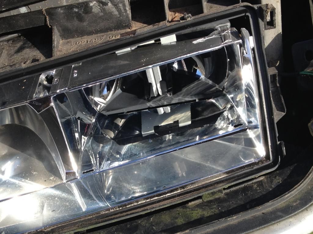

A few things done today. I replaced the existing dipped bulbs with my GE Ultrabright 120%s and took the nose cone off to remove the headlight glasses and fresnels. The silvering was filthy so a bit of a clean and it's a lot shinier.
Soaked the Fresnels in peroxide solution for not long enough but they are certainly lighter - I need to get a second set and let them stand for days and then replace, but having had all the lens covers off and cleaned the lights are working far far better now.
The nearside front indicator wasn't working and replacing the bulb made no difference. I'll have to look at this another day as wiring really isn't my (low) pay grade.

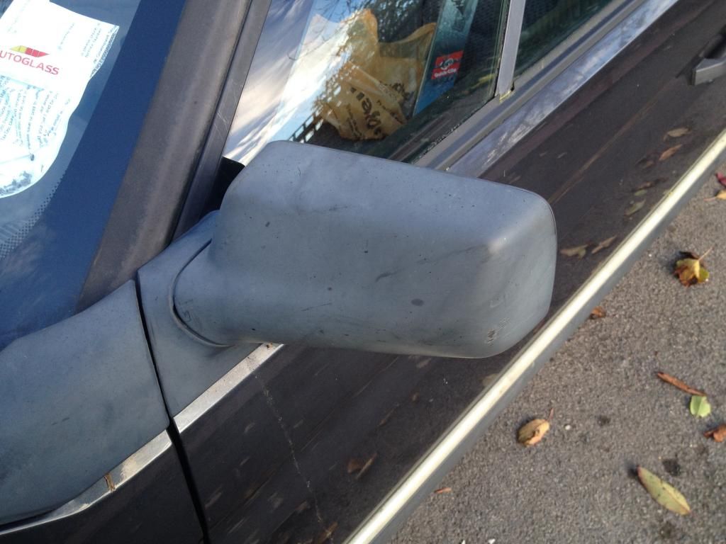

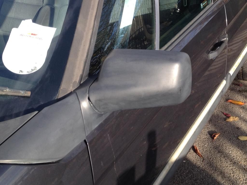

Plastics have got very faded so did some blackening - a significant improvement, more so if I keep doing it and polishing the results!
Before
After
Tomorrow, if sunny enough, a good clean to get to see what the paintwork is doing. I might even try a little T cutting.

A cheap quick fix to get the black trims black again is to use some nut oil, linseed oil, Vaseline or peanut butter...non chunky, and they will replenish the oils.
Might be worth trying a cutting compound coarser than t cut too to get the white off. I am sure mine where as bad as yours when I went to see it for the first time...and they must have been cut back and treated in a similar fashion.
Remember Charles, you need sunshine or some sort of UV light for the peroxide to work properly.
Interesting Russ, I have lots of nut oil in the cupboard. The fresnels were out in the sunshine with the peroxide today, I knew it was not going to do much in the time but it's better than it was.

Vince put me onto Meguiars Ultimate Protectant Dash & Trim Restorer. I swear by it now, it brings all the black plastic and rubber back to black with ease.
