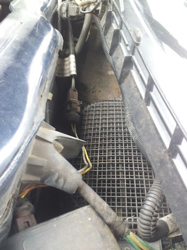

Reconnected everything, and got to this, which I presume is the coolant temperature sensor?
