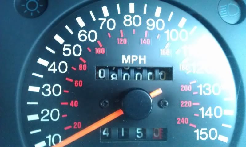

Whilst in Portsmouth, the 19 year old Citroen clicked over 80,000 miles. I decided to record the moment for prosperity.

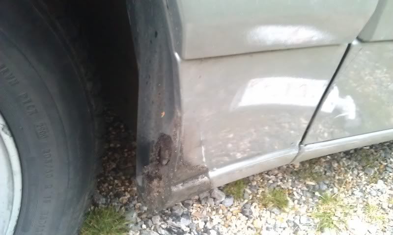

Once home, I decided to remove the mudflaps. This was so I could decided if I should leave them or not, however every single bolt snapped so the mudguards are off for now!
This is what was hidden behind the mudflap.

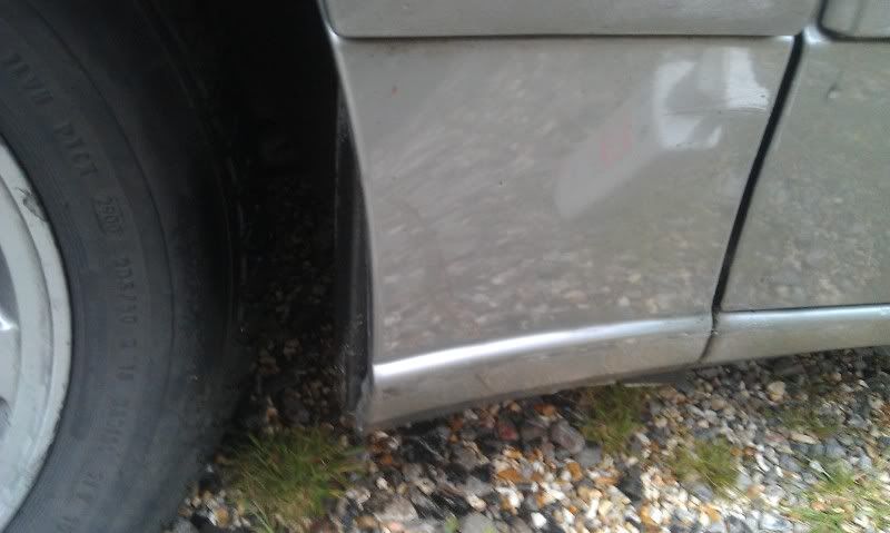

Which cleaned up very well indeed
I think it is an improvement..

There may well be a load of soil, road grit etc In the space behind the bottom of the wheel arch liner.
Regular rust spot as it collects there over the years and stays damp.

xmexclusive wrote:There may well be a load of soil, road grit etc In the space behind the bottom of the wheel arch liner.
Indeed there was John. I have cleared the area out, and it' looks in great condition. To be honest, the whole car is immaculate. It really is as clean as it looks.

I am glad you are still pleased with the car, although I would put the mudflaps back on myself after cleaning inside the wings, partly for originality plus they do keep the lower body clean.
