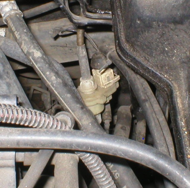

Re: Speedo Cable
Mine's mid-cable...
There she is, just to the left and just below the LHM Reservoir...

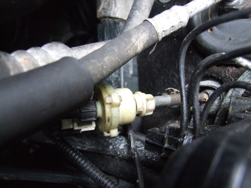

Re: Speedo Cable
This is mine. I think it might be like yours Jim.....
Actually, looking at them they are slightly different. The sensor plug is the other way round on mine.
Re: Speedo Cable
That's the same Russ, except yours is upside down compared to mine... You have the Antipodean version. Good job it doesn't drive the speedo or it would read backwards...
Once the speedo cables are disconnected at each end you'll find there's a lot of leeway as to where the sensor can go - the electrical cable has plenty of spare length on it- or at least it does in mine - and this makes speedo cable lengths less than critical...
